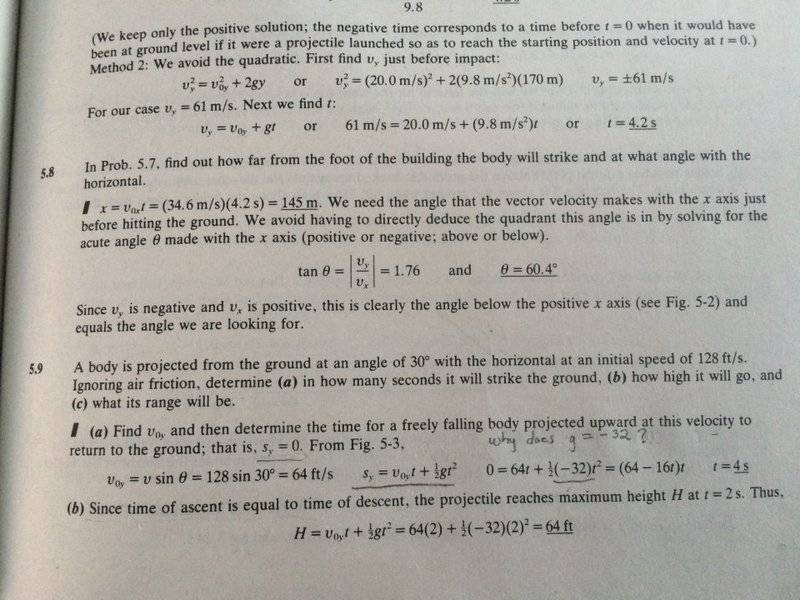

The problem (5.9) and given data is attached.
All relevant equations are given (5.9).
On (5.9) What does the s subscript y represent? And why does gravity equal -32?
The solution is given. This is a scan problem.
They are using the variable s to represent distance (This is a common practice in some texts). So ##s_y## would be the distance in the "y" (vertical) direction. ##32 ft/s^2## is the gravitational acceleration using feet rather than meters for distance.
Thank you gneill. Is the distance in the "y" vertical direction 0 because its final position is the ground?
It's 0 at the beginning and end of the trajectory, both at ground level.
