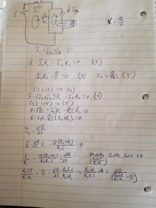

the attached files are a diagram of the circuit. also I believe I figured out how to proof equation (7) but I'm lost on how to proof (8)

Your derivation of (7) looks good to me. The second line of the second page could be fixed up a bit. It is missing a parenthesis on the right-hand side and the limits of integration are not indicated.
