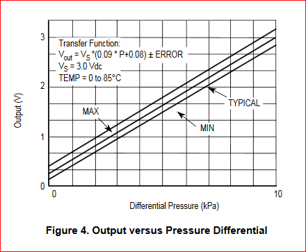

I'll add, for sake of completeness you could have included the following:

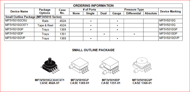

Which one do you have ? From datasheet you linked there are four varieties
as to its operation, again from datasheet
Again from datasheet
Vout = VSx (0.09 x P + 0.08)
so
If VS = 3 as recommended
(sanity check : 0 pressure gives +0.24 volts)
Vout/3 = .09P +.08
P= (Vout/3 - .08) /.09
P = Vout X 3.704 - .8889
i do not see how any Vout more positive than 0.24 volts could be interpreted as negative pressure.
What voltage did you get ?

Keerthana_28 said:
Voltage= 0.280645
so
Vout/3 = .09P +.08
Voltage= 0.280645 (What the heck kind of meter do you have ? Gives me digit envy !)
+0.280645 X 3.704 -0.8889 = + 0.1506
now datasheet didn't say what are units
but i'd think from their graph it's kilopascals
That's .15 kpa out of 10 kpa range? That's error of only about 1.5% of span. Not bad for a "fresh out of the box" untouched ±5% gizmo.
so next question is at what condition did you measure .280+++ volts? Both ports open to air? No water inside the sensor?
Horizontal or vertical?

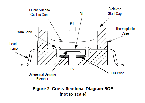

You'll probably find a small difference when the sensor is held in vertical vs horizontal plane. That's because Gravity pulls on its "differential sensing element" .
So
open both ports to air, place it in the position you intend to use it and measure Vout. That is the number you'll use in place of of 0.24 in the transfer function. Notice that your 0.28++++ falls within the specified range of 0.1 to 0.38 volts.
