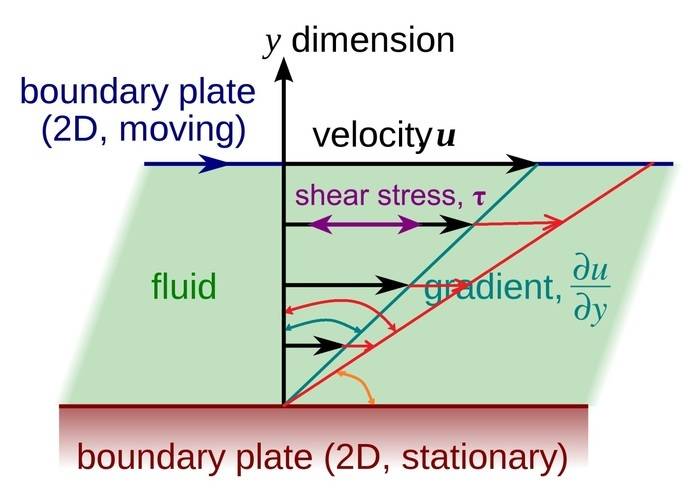

I couldn't understand this part either.According to Newton's law of Viscosity,
τshear=μ.(du/dy)
To maintain a constant shear stress at the interface we need the velocity gradient to be constant as viscosity is always constant for a fluid.The velocity gradient is constant only after the plate has achieved a constant velocity.During its transient motion the velocity gradient is likely to change as explained earlier.
For an easy understanding in the picture above we see the velocity profile for the case under consideration.Since we have already discussed for the transient part of motion the velocity of the upper plate increases with time (plate is accelerating) so the velocity profile must changes it's shape with time.In the figure above the velocity profile has changed it's shape to the one shown in red extension of the profile.One may clearly see the gradient which is the slope u/∂y varies with time as u=u(y,t).The slope increases as the velocity of the upper plate increases with time.So the shear stress increases with time until the shear force balances the force on the upper plate when the plate keeps moving with a constant velocity.This was my precise understanding I wanted to share.
But I will tell you where I went wrong!The slope ∂
u/∂y in the figure above is the angle the velocity profile makes with the y-axis.So the angle increases as the velocity of the upper plate increases with time while in transient motion and so does the shear stress.I was considering the angle the velocity profile makes with the u-axis which was decreasing as the upper plate was accelerating so I thought the shear stress would have continually decreased with the acceleration of the plate and the stage would never come when it would balance the constant external force on the plate!
I know I am stupid at times but I am glad I finally arrive at the meaningful conclusion:D

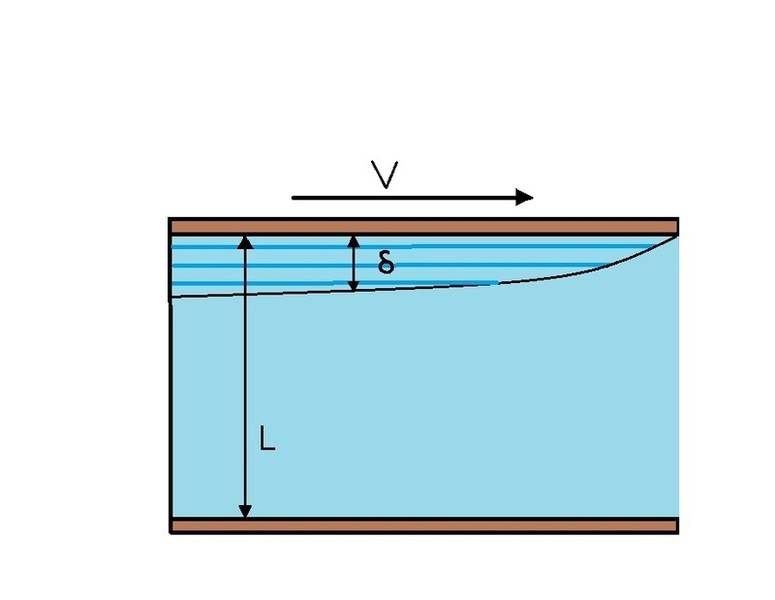

Let's start out by just talking about what's happening physically at short times. We'll consider the case of constant plate velocity V. At short times, there develops a thin region of fluid of nominal thickness δ immediately adjacent to the moving plate in which the velocity is varying very rapidly with distance from the plate. The fluid velocity at the plate is V, and the velocity at y = L - δ is essentially equal to zero. At distances greater than δ from the plate, the fluid velocity is zero. As time progresses, the thickness of this boundary layer increases until the boundary layer penetrates to the lower plate at y = 0. So the boundary layer thickness is a function of time δ(t). (This is only an approximate picture of the velocity profile, but it is adequate for our purposes).
As a first approximation to the velocity profile (before the boundary layer penetrates to y = 0), we can write:
[itex]v=V\left(1-\frac{(L-y)}{δ}\right)^2[/itex] for (L-δ) < y < L
[itex]v=0[/itex] for y < (L-δ)
From these equations,
What is the velocity at y = L?
What is the velocity at y = (L-δ)
What is the equation for the velocity gradient dv/dy?
What is the velocity gradient at y = L?
What is the velocity gradient at y = (L-δ)?
What is the velocity gradient below y = (L-δ)?
According to this description, the fluid below y = (L-δ) does not even know that the plate is moving yet. Can you see that? Why do you think it is that the velocity profile is curved? Which part of the fluid has been accelerated, and which part has not been accelerated yet?
I'll continue after I hear back from you.

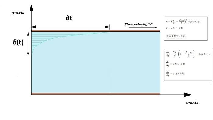

http://[PLAIN]http://i58.tinypic.com/2ag7zfd.jpg
This figure does not represent what is happening in our specific physical situation. In our situation, the fluid stream lines remain perfectly horizontal (i.e., constant y). Think of it as a deck of cards that is being sheared.
At y=L, dv/dy=0
No. This one is not correct. Please try again.
Because the velocity varies non uniformly with y i.e, dv/dy=f(y).
Sorry. I didn't mean mathematically. I meant, physically, why do you think that the velocity profile is curved?

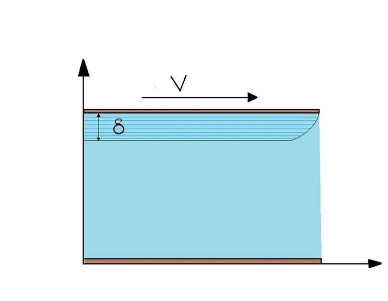

Could you draw the velocity profile for the approximation?
It would give me a better pictorial understanding.
In your previous post you didn't mention what is represented by "L".Assuming that the distance between the two plates is denoted by "L" and y is measured from the lower plate vertically upwards, the velocity gradient at y=L should be dv/dy at y=L where v=V.(V is the upper plate velocity)
So, dv/dy at y=L ⇔ dV/dy=0 (since the plate velocity is constant and the fluid layer immediately adjacent to the plate should have the same velocity as the plate.)
I might be wrong in my understanding but unable to see where.Please clarify.
I would like you (rather than me) to draw a graph of the velocity profile. Make y the vertical axis, and make v the horizontal axis. Do it at one value of time t.
Yes, L is the gap between the plates. In your previous post, you correctly wrote:
[tex]\frac{\partial v}{\partial y}=\frac{2V}{\delta}\left(1-\frac{(L-y)}{\delta}\right)[/tex]
From this, at y = L, I get:
[tex]\frac{\partial v}{\partial y}=\frac{2V}{\delta}[/tex] at y =L
Each layer of the fluid is acted upon by a net forward force which is different for the fluid layers resulting in different accelerations for the fluid layers.
Excellent.
For the velocity distribution formulated as an approximation,
[itex]v=0[/itex] for y < (L-δ)Thus,
can be used for (L-δ) < y < L but not at y=L.(that is y cannot touch the value L for the velocity gradient to be approximated by the formula.)

Soumalya said:
Yes I would like to proceed with the analysis now.
Soumalya said:
This graph is not correct. The velocity and the velocity gradient are continuous at y = L-δ, and your curvature is flipped. Just assume some values for L and δ, and plot the points.
This is not correct. The equation actually applies right up to y = L. The no-slip boundary condition requires only that the fluid velocity matches the boundary velocity. It does not require that the velocity gradient be zero. Certainly, in the steady state solution, the velocity gradient is not zero. Otherwise the shear stress at the boundary would be zero, which it obviously is not.
Chet
Soumalya said:

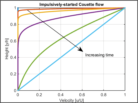

I think I see where you confusing yourself here based on these two images. You are viewing the ##\delta## in this case as if it was a boundary layer developing over a semi-infinite flat plate (i.e. with a leading edge) and have therefore drawn each figure sort of like you would see a Blasius boundary layer on a flat plate develop rather than what it would look like with an infinite flat plate moving over the liquid where this ##\delta## will be the same for any value of ##x## (or ##z## for that matter if this was three-dimensional).
What @Chestermiller is asking you to do is plot the velocity profile ##v = v(y)## of the fluid between the two plates. This profile should be some shape of line stretching from one plate all the way to the other for a given instant in time. He seems to want you to just pick some instant in time after the plate has accelerated and before the system reaches steady state and try to draw it.
Soumalya said:
Thus,
As you approach the plate from below, the velocity is changing, so it clearly has a finite value of ##dv/dy## at all of those points and continues to change right up until it hits the plate. After all, the fluid at the plate is moving with ##v=V## but the very nearest parcel of fluid is moving with ##v < V##. For calculating shear stress at the wall (which is ultimately what the goal here is), you are therefore finding ##dv/dy## at the wall as the wall is approached from below. Just because the velocity at the wall is constant in time does not mean it is constant in space through the fluid.
boneh3ad said:
I think I see where you confusing yourself here based on these two images. You are viewing the δ\delta in this case as if it was a boundary layer developing over a semi-infinite flat plate (i.e. with a leading edge) and have therefore drawn each figure sort of like you would see a Blasius boundary layer on a flat plate develop rather than what it would look like with an infinite flat plate moving over the liquid where this δ\delta will be the same for any value of xx (or zz for that matter if this was three-dimensional).
Yes you are correct.I was visualizing the situation incorrectly.In fact the figures were nowhere near the actual situation.I am glad you pointed out the mistake so precisely:)
boneh3ad said:
What @Chestermiller is asking you to do is plot the velocity profile v=v(y)v = v(y) of the fluid between the two plates. This profile should be some shape of line stretching from one plate all the way to the other for a given instant in time. He seems to want you to just pick some instant in time after the plate has accelerated and before the system reaches steady state and try to draw it.
Yes I noticed in the figures above the velocity profile was discontinuous at y=L-δ whereas it should have been continuous at all values of 'y' and monotonically increasing from y=0 to y=L.

The shear stress at the moving plate is not due to the fluid layer directly below it because the relative velocity of the fluid layer immediately adjacent to the moving plate to the plate is zero.Hence, the shear stress is due to the fluid layer next to the fluid layer sticking to the moving plate (adhesion) due to the existence of relative velocity between them along with the property of viscosity.
Is this one correct?
Yes. This is correct. But, what is that partial with respect to t doing as a label on the figure?
I am sorry but that should have been 'δt' instead of '∂t' which denotes a very small change in time.I have considered the velocity profile at an instant δt after the motion of the plate was set.I thought as δ was already used to denote boundary layer thickness in the figure it would be confusing to use it again as a very small change in time 't'. :DD
The figure you have drawn is not the velocity profile at the very instant after the motion of the plate was set. It is at a significant time t after time t = 0, after the boundary layer has had time to grow a little.
Understood.Let it be at an instant t+δt after the plate was set to motion so that the boundary layer had enough time to develop.
