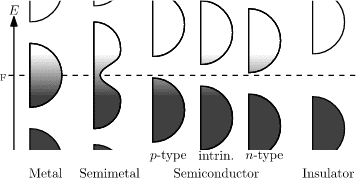

Just a little note for OP: when @TeethWhitener said "no bandgap", he basically means this:
(From wikipedia: https://en.wikipedia.org/wiki/Semimetal)
Despite mercury having smaller contribution of 6s orbitals thereby showing low conductivity, they still have no bandgap, which means that mercury is still metallic in terms of its electrical conductivity.

Gray tin and graphite are both semimetals. I gave the technical definition of this earlier. The upshot is that they have no band gap, but they also have a very low density of states at the Fermi level.
Non-metals (semiconductors and insulators) have a band gap. That is how they are defined. A consequence of this is that their conductivity is orders of magnitude lower than that of metals.

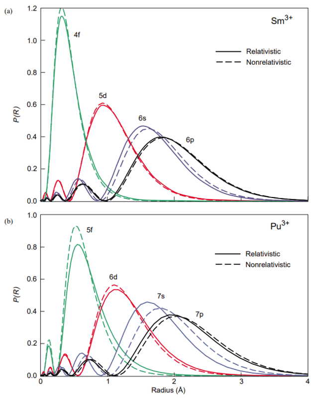

TeethWhitener said:
Of all the cases mentioned, manganese and the actinides are the most interesting. The actinides undergo self-radiation damage, but beyond that, the 5f valence band is more localized than the (energetically) deeper 6s band. This is also the reason why all actinides and lanthanides are found almost exclusively in the +3 oxidation state. Basically, the outermost electrons of the lanthanides and actinides are not the valence electrons. In actinides, this is more pronounced due to relativistic effects, which contract the 5f orbitals. All these factors lead to localization of electrons in the metal and decreased conductivity.
A little nitpickey point: Actually, the relativistic effect does not contract the 5f and 4f orbitals, it indirectly does the opposite.
(Radial function of orbitals, taken from "The Chemical Complexity of Plutonium" by David L. Clarke, Los Alamos Science 2000.)
The reason is because the spherically symmetric inner s and p orbitals are contracted inwards by relativistic effects, which in turn shields the effective charge of the nucleus, and causes spherically asymmetric f and d orbitals to extend outwards. A similar effect is observed in lanthanides but they are lighter than actinides; the relativistic effect is not as pronounced.
As you mentioned, both in lanthanides and actinides, the outer electrons are not valence electrons, so they contribute minimally with bonding. Instead, orbitals like 5d, 6s, 6p (lanthanides) and 6d, 7s, 7p (actinides) are involved. Due to their large ionic radii, they have strong ionic character than covalent character in bonding. However, for actinides, you can see from the figure that 5f-orbital tails are distributed farther out, which means that they can still get more involved in bonding compared to lanthanides. This also explains why actinides can show more variety in oxidization states compared to lanthanides.
Likes TeethWhitener
