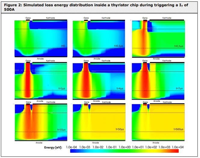

I can't school you. I wouldn't suggest I know much at all, but figured it's worth mentioning that there's a small section in a very popular power electronics book by Erickson in the switch realization chapter (chapter 4) they talk about Thyristors/SCRs and a few of the challenges with it. I personally don't know much myself, but since it's a seemingly popular book... I remember reading that chapter and grabbed my book... there it was :) so hopefully a copy might be within reach?
Something they seem to focus on is that it has a very large gate and this causes several challenges such as current focusing (has to ramp up slowly during turn on); also turning it off by regular gate control is apparently hard and reverse biasing doesn't resolve that problem very well (reverse current also instead of to the gate and causes a voltage drop). GTO seems to be less problematic in these aspects but has lower ratings. I think another similar device they mentions is a MOS-controlled thyristor (MCT).

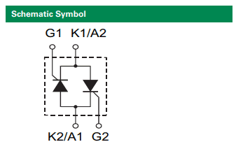

Then I found this guy:
https://www.littelfuse.com/~/media/...ristor_module_ms0690j_dl1te_datasheet.pdf.pdf
This would imply each gate needs to be isolated and floating:
But this would suggest that thyrsitors in general are not going to be able to do the job, 500V/us indeed, lol.

Yes - you typically picket-fence the gate current relative to the positive cycle. Injecting current when reverse biased will increase leakage and thus losses. So the firing circuit usually has a comparator type "and" to ensure this.
Here is a more indepth Ap Note : https://www.semikron.com/dl/service...iodes-and-thyristors-en-2018-11-19-rev-02.pdf
