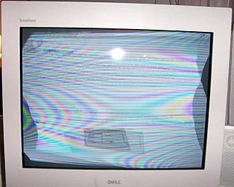

hutchphd said:
(degaussing)
Brings back memories of degaussing TV picture tubes and computer monitors.
From: https://en.wikipedia.org/wiki/Degaussing
Likes russ_watters and berkeman
