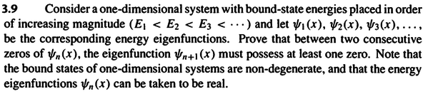

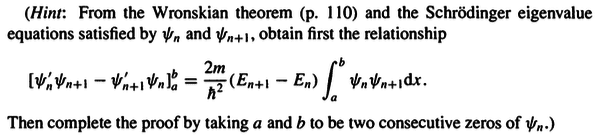

Wronskian theorem:
I've gotten the relationship given by the question but I do not know how to continue.
Since ##\psi_n(a)=\psi_n(b)=0##,
LHS ##=\psi_n'(b)\,\psi_{n+1}(b)-\psi_n'(a)\,\psi_{n+1}(a)##
If LHS ##=0##, RHS ##=0##, then by the First Mean Value Theorem for Integrals, ##\psi_{n+1}(c)=0## for some ##c\in(a,b)##.
But LHS is not necessarily ##0##.
Attached below is the derivation of Wronskian theorem.
As a and b are consecutive zeros of ##\psi_n##, ##\psi_n## won't change sign between a and b.
Assume, without loss of generality, that ##\psi_n## is positive between a and b.
What does that tell you about the signs of ##\psi_n'(a)## and ##\psi_n'(b)##?
Now assume that ##\psi_{n+1}## has no zeros between a and b. It follows that ##\psi_{n+1}## won't change sign between a and b.
Now just check what the signs of the two expressions will be (remember that ##E_{n+1}>E_n##).
