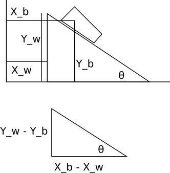

A 45 deg wedge is pushed along a table with a constant accelaration A. A block of mass m slides without friction on the wedge. Find its accelaration.
##(x_b - x_w)\tan \theta = h -y_b##
##\ddot x_b + \ddot y_b = A##
Now equating forces horizontal and vertical forces on the block,
##N\cos \theta - mg = m \ddot y_b##
##N\sin\theta = m \ddot x_b##
Substituting these two in constraint equation,
##\sqrt{2}\times N = mg - mA##
##N = \dfrac{m}{2}(g + A)##
Substituting this back in the equations of forces on the block,
##\ddot x_b = \dfrac{g + A}{2}## and ##\ddot y_b = \dfrac{A - g}{2}##.
This is correct but if I take ##mg -N\cos \theta = m \ddot y_b## I get a wrong answer. For me, since the block is moving downward , ##mg -N\cos \theta## feels more natural and correct than ##-mg +N\cos \theta ##.
Anyway it does not give correct answer it gives ##A = g## which is wrong. I want to know why ?

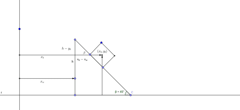

In the small triangle,
##\tan \beta = \dfrac{h - y_b}{x_b - x_w} \iff (x_b - x_w)\tan \beta = h - y_b \iff (\ddot x_b - \ddot x_w)\tan \beta = -\ddot y_b##
Since ##\beta = \theta = 45^\circ##, ##\tan \beta = 1##.
##\ddot x_b - \ddot x_w = -\ddot y_b##.
Oh, ok.
Very sorry, but because I engage in many threads at once I sometimes forget some crucial fact about a problem. In this case I forgot you had already explained θ is 45°. So now I agree with all your equations and can only apologise for all the noise.
Moving on to your original question:
Buffu said:
since the block is moving downward , ##mg -N\cos \theta ## feels more natural and correct
You have defined y as positive upwards, so ##\ddot y## is positive upwards. In the equation ##\Sigma F_y=m\ddot y##, the forces must also be written as positive upwards, so ##N\cos \theta-mg ##.
