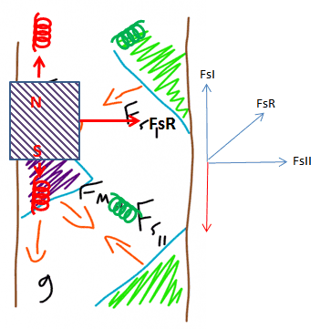

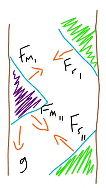

So for a personal project I want to calculate the force necessary for a solenoid (electromagnetic coil) to keep a permanent magnet triangle locked diagonally up and down at the same time so that it does not move in any direction. I need to know the values for coil thickness, amps, turns, and pretty much anything else necessary. The distance should be around 2 mm separation between faces and the weight of the triangle is around 2 kg. In the sketch, the green things are electromagnets attracting with forces Fsi and Fsii and purple is the triangle with forces Fmi and Fmii, all magnets are horizontally locked by the wall, it is just a vertical movement controlled by the magnets pulling on the triangle. This is not a homework or anything so feel free to give comments, formulas (hopefully with links to source), or any information I could use.
In order to fix the magnet in space the solenoid forces should act in opposite sides. If the angle between forces is less than 180 degrees then a resultant force is present.
Ok wow thanks for the sketch and reply. Let's see if I understand though. Why does Fsi result vertically up only and Fsii result horizontally to the right only? Fsi is directly in front of Fmi and Fsii is with Fmi so that both Fs forces are pulling the triangle towards them, therefore balancing out vertically if we ignore weight. Horizontally, movement is locked since the solenoids and triangle magnet are locked to the brown walls by means of say rollers so that the don't rotate or get separated from the wall.
You can also assume there is an isolating wall between solenoids which can partially prevent the fields from affecting each other.
Finally, the degree between solenoids is 90 so that the resulting pull force would be right and a little bit down due to weight.
At first you have to control the currents so the resultant vertical force will be exact the 2 kg .
Second you can calculate the required force FsII*sin(a)=FsI*sin(b)+g where a and b are
the angles between force vectors and the horizontal line.

If do you mean if the distance between solenoids does matter, in my opinion, what does is the force direction only. It has to be against the magnet, of course. However, since the horizontal motion is not allowed so rotation also is not possible.
