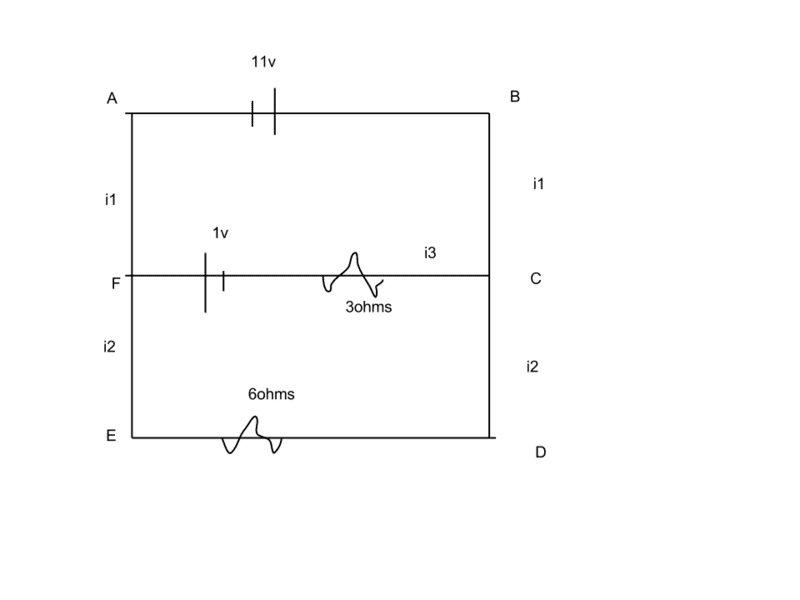

Linked below is a rough picture of the circuit for which I need to find the currents.
https://docs.google.com/drawings/pub?id=1jY6r1yjOf9OG5VixjZKcQbG2rj-ZQ7LZzaybGzkjva0&w=960&h=720
Kichhoff's Laws, Ohm's Law.
I'm doing a self-study using a book that I think may be riddled with errata, so I keep finding that I'm getting a result which disagrees with the answer the back and cannot see why my answer differs. I get the system of equations
[itex]11 - 3i_{3} + 1 = 0[/itex]
[itex]11 + 6i_{2} = 0 [/itex]
[itex]-3i_{3} + 1 -6i_{2} = 0[/itex]
[itex] i_{3}=i_{1}+i_{2}[/itex]
I believe my choice of direction of flow is consistent and cannot affect my solution up to a change of sign. The book produces the result that [itex]i_{2}=13/6[/itex] when I obtain 11/6.

If i2 = 11/6 A, then the voltage drop across the 6Ω resistor is 11 V, which makes perfect sense. So, it looks like you are correct !
I agree. The voltage across the 6 ohm resistor is fixed at 11V so the current is simply 11/6 amps.
Have they/you labelled the currents correctly?
