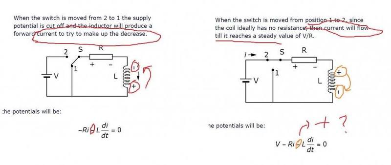

Why the -Ldi/dt in the left side is minus but not plus sign
i got confused
Does everyone can help me in this problem
thank you
i know V-Ri-Ldi/dt=0 is true in the right hand side
however,it doesn't make sense that the "-L di/dt" term is still the same
when the di/dt is decreasing rather than increasing in the left hand side.
V=0
the direction of the induced emf is reverseing(so it should be Ldi/dt but not- Ldi/dt?)
the Ri is still the same when the i is in the same direction as before.
i think it should be L*di/dt-Ri=0
what's wrong with that?

The inductor causes a back EMF, so that the equation reads ## V-L \, dI \, /dt=IR ##. The reason it occurs in this direction is ## L=\Phi/I ## where ## \Phi ## is the magnetic flux. By Faraday's law, the EMF from the inductor is ## \varepsilon=-d \Phi/dt ##.

But if V=0 than the di/dt will decreasing
than -L di/dt will become L di/dt ?
the sign reverse when the rate of current change is decreasing?
i understand why V-L(di/dt)-Ri=0 is true
but when V=0 ,then (di/dt)will not increases but decreasing(so that (di/dt)will become (-di/dt))
therefore the whole terms will reverses its sign(from -L di/dt to L di/dt--> the direction of induced emf is in opposite way)?
but nothing happen? why?
the term (-Ldi/dt) in both side are the same even the direction of voltage supply(induced emf)is in opposite way

For V=0, the differential equation is ## L \, (dI /dt)+IR=0 ## and the solution is ## I(t)=Aexp(-(R/L)t) ##.When the current starts to decrease,e.g. if we shut off a DC voltage, there is a forward EMF in the inductor that attempts to keep the current from changing.

this is the correct solution in phyiscal sense.
yes you are right.
But i got no mathematical sense in this solution.
why we don't need to reverse its sign when there is forward EMF in the inductor to keep current changing(in the V=/0 case,it is clearly the EMF is backward but not forward)
if backward EMF= -L (di/dt)
then it is reasonable to think the forward EMF= +L(di/dt)
So: V-Ri-L(di/dt)=0
should becomes 0-Ri+L(di/dt)=0
clearly your solution is correct but mine is wrong
my reasoning got wrong when i try to think like this,why?

When the current is decreasing, ## dI/dt ## is negative, so that ## \varepsilon=-L (dI/dt) ## is positive and thus a forward EMF.

Your calculations are correct. The EMF that gets generated will be in the same direction as the current and the original DC voltage that was removed. Meanwhile, if you turn on a voltage source with zero current, the EMF that gets generated will be a back EMF that resists any change.

Just one additional comment: Your equation inside the quotes is incorrect. You can't arbitrarily change the sign of these terms. Your first equation above it is correct.

When you begin, you need to assign one direction, e.g. clockwise, as positive. In the solution ## I(t)=Aexp(-(R/L)t) ## when we say ## I ## is decreasing and ## dI/dt ## is negative, we are assuming ## A ## is positive. The same differential equation, ## V=IR+L(dI/dt) ## works equally well for negative (counterclockwise) currents and voltages.

The Minus sign is just to follow Lenz's Law and it is the electrical equivalent of Newton's Third Law. Both statements imply that there is a reaction against change. Without the negative sign, the current would increase without limit or the trolley you push against would accelerate without an applied external force.
The Maths behind this just follows the normal conventions for how signs can be moved about inside formulae and equations.
