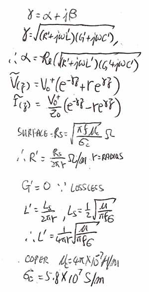

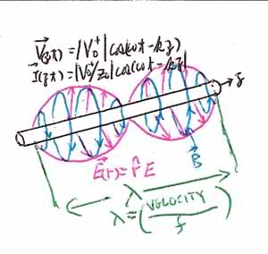

Speed of EM travel through the good conductor is [tex]\omega[/tex]/[tex]\beta[/tex]
I know the speed of signal travel in stripline is c/[tex]\sqrt{}\epsilon[/tex][tex]_{}r[/tex]_{}
My symbols don't look very good but I think you get what I mean. Obvious they are different.
I am confuse because in both case EM wave travel in good conductor, why are they different?
I know the first one is "propagation velocity" the second is "phase velocity". What is the difference?

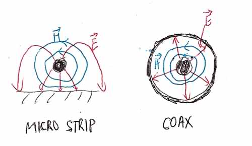

I guess my question: What is the difference between EM wave travel in stripline and EM wave travel in a media. Is it the first one is conduction current and the second is displacement current.

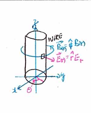

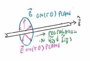

Consider a long bar with x be the in direction of the length. Width be the y direction and the thickness in z direction. Let current flow in +ve x direction from one end of the bar to the other end.
1) Since the current from in +ve x direction. THis mean E wave is in direction of x. ( E wave is parallel to the length of the bar )
2) E wave induce H wave which is in y direction. ( parallel to the width of the bar)
3) The direction of propagation is normal to both E and H wave which is (x X y = z) So the EM wave actually propagate down in direction of the thickness of the bar.
Therefore the velocity of current travel along the bar is DIFFERENT from the propagation velocity of EM wave in good conductor.

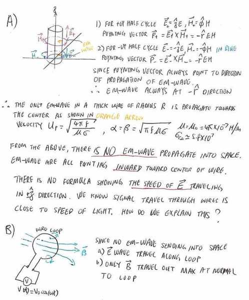

Actually you gave me a lot of fruitful thoughs. Since your last post, I was kicking myself, I study those before, just not enough to become a common sense to apply freely! I print out your comments and the link and study it. Here is more question from thinking in the last two days.
From part A of the drawing, I proved that EM-wave propagate towards the center of the thick wire. I show in instanteneous form using sine wave in +ve and -ve direction separately to prove both case, no EM-wave propagate into space(to the surrounding medium). E wave is always in direction of current which is just AC current of cos([tex]\omega[/tex]t). That means E is along the length of the wire. Question is what is the speed of the signal through the wire even though you show me clearly that the electron move very very slow in the wire. Somehow the signal do travel close to speed of light as we all know.
Further in Part B I show a loop antenna make of the same thick wire and driven by signal generator as shown. If my intupretation is correct, no EM-wave emmited from the loop directly. Only M wave propagate out as shown. E wave can only from the M wave that propagate out, not from the original current through the loop.
This is what I think so far, please give me more feedback.

I haven't looked into the details of a conductor as much as you are now. There are some
interesting points. The negative of the integral(PdA) is quntity of energy. In the DC form
your drawing is commonly used to model cylindrical resistors, where the energy moves
into the resistive material, then is dissipated as heat. But, then, this model shouldn't work
for a superconductor. I don't see why it doesn't.
An infinitely long conductor in empty space should be the same as a coaxial cable
with the outer conductor at infinity; R-->infinity. The Poynting vector at the surface
of the outer conductor has it's own Poynting vector. This is a conserved field in empty
space ('cause energy is conserved), so somehow all of these Poynting vectors have to
origintate at the source of EMF.
Your second drawing is a loop antenna. It has the same radiation pattern as a dipole
antenna at large distances. Where the distance R>>wave_length, the space around the
loop is dominated by propagating fields. So there is an accompanying electric field, and
the ratio of the electric to the magnetic field strengths is that of radiation in a vacuum.
The near fields are not the same as the far fields, but I only know the rough details.
If we put a receiver antenna at one loop radius distance, we're more likely to call the
arrangement a transformer and the field coupling is not same as the coupling from
transmitted radiation between loop transmitter and loop receiver.
You've picked an interesting course of study. Did you say it was work related? I almost
wish I had an excuse to pursue it, myself.

I did some refreshing on transmission line theory. I think what you said might be true, that is how I kind of thinking too.
The long wire should be treated as COAX with very thick dielectric...air. So [tex]\mu[/tex] = [tex]\mu[/tex][tex]_{0}[/tex], [tex]\epsilon[/tex] = [tex]\epsilon[/tex][tex]_{0}[/tex].
This will give velocity of light and [tex]\eta[/tex] =377 ohm.
So RF current through a straight wire actually GENERATE 2 EM waves:
1) The usual EM wave that point inward towards the center of the wire. This is the one that cause the skin effect.
2) The EM wave from launching into the COAX line formed by the length of the wire with air as dielectric.
I hope Someone can comment with some certainty. I cannot find anything like this in 6 books I have!

1) The Primary poynting vector always point inward. I was making this assumption like yours until I calculate the poynting vector separately on +ve and -ve half of the cosine wave. That is the reason I show 2 calculation in my drawing. Take a look to see whether you agree. I could be wrong. The reason is because as the E wave change direction, so is the H wave, and E X H still pointing at -r.
2) The secondary poynting vector from launching the EM wave onto the transmission line formed by the long wire is in the direction of the wire. Let me know what you think.

Yes I broke into two separate parts. The last post that I wrote, I think is in agreement with yours.
1) In my original question, the signal launch into the transmission line as Voltage and Current phasor, not as EM wave. The EM field that is generated only in form of the poynting vector pointing into the center of the wire. This is the main cause of skin effect.
2) The energy launch into the transmission line only as Voltage and Current phasor. I think this is what you read in the physics textbook. The the current in the transmission line generate a secondary EM wave: Radial E field line radiating out of the the surface of the wire and is normal to the surface of the wire and the H field is circling around the wire. The result is just like the textbook drawing of the field pattern of a coax line. In the long wire case here, the surrounding space is considered as the dielectric of the coax. Current on the wire generate the secondary EM wave that travel into the space. I hope we are getting somewhere.
I think back to my original question: What is the speed of the current travel in the wire conductor. The answer should be speed of light 3EE8 m/s. The answer comes from the fact that The wire is treated as coax with infinite thick dielectric. The energy launch into the line only in form of Voltage and Current phasor with velocity = [tex]\omega[/tex] / [tex]\beta[/tex] . In this case, it should be close to the speed of light.

In fact I think you help a lot. The idea you suggested of looking at the wire as coax is a light bulb moment! I was thinking about the secondary effect and this solidified the idea.
The wire can be treated as either coax or micro-strip as shown
That solidify the idea of launching the signal onto the transmission line. That answer the question on the speed of the wave travel on the wire.
Thank you very much.

I have an idea, that might work. This thread has become very long, so anyone checking-in
for the first time will probably give up after the first page or two. Also, when you posted
your drawing, the long width confuzzled the software so that the text stretchs too wide.
Now that you know (and me too) you could crop the drawing width before posting.
So you might re-post your theory, as in introductory question, in the electrical engineering
thread and hope for the best. If that fails, we can always continue here I hope.
I've re-read all your post and I'm not sure what your theory is, at this point.
Sorry if I'm obtuse.
Next, I have made some progress. To start out as simple as possible, I consider an ideally
conductive coaxial cable with vacuum dialectric. The coordinates are z, r and theta in
cylindrical coordinates. For a first-pass analysis I'm essentially ignoring negative signs
sometimes, and the values of epsilon, mu and even pi I set equal to 1 sometimes. I'm just
using portionals.
The whole idea of this is to eventually get to resistive conductors (good conductors, as
your text calls them) and the primary wave that moves into the conductor , but I have to
start with the ideal conductor case. So this is what I have so far.
The electric field surrounding the center wire is directed radially, only (this is because it's a
perfect conductor). The strength of E_z drops off inversely with the radius; Gauss's Law for
electric charge.
[tex] \textbf{E} = E_r \propto \frac{1}{r} \hat{r}[/tex]​
The z dependence is intuitive when we assume a propagating waves at one frequency in
the positive z direction. It turns out to work correctly. I'm ignoring the velocity, the ratio
of k/omega for now.
[tex]E_r \propto cos (kz - \omega t)[/tex]​
The electric field doen't vary with theta because it's directed radially.
Using the Maxwell Faraday equation in integral form, the rate change in magnetic flux,
with respect to time can be found around rectangular loops in a plane of constant z
in the vacuum between the wire and the shield. The magnetic field stength results from
differentiating over the area of the loop. The magnetic field connsists of circular loops at
constant z.
[tex]\textbf{B} = B_\theta \propto \frac{1}{r} \hat{r}[/tex]​
This makes things easy. No nasty Bessel functions will get in the way. :smile: When B
is proportional to 1/r the integral of B around every loop is the same. Applying Ampere's
curcuital law, give the current, J in the conductor. There can't be any dE_z/dt or in the
space between the wire and shield or the integral of B around inner conductor would be
different in each loop. This is what makes things simple. (Now that I think about it, there
could still be an axial electric field inside the wire. I'll have to think about that one further.)
With all this, it turns out that the magnetic field is in phase with the electric field.
[tex]B_\theta \propto cos(kx-\omega t)[/tex]​
using portionals.
I want to verify the coordinates. This is my intepritation:
perfect conductor). The strength of E_z Do you mean E_r?drops off inversely with the radius; Gauss's Law for
electric charge.

This is how I picture it:
The Er radiate normal to surface of the wire and Br circle around the wire. Both on r[tex]\theta[/tex] plane where propagation is in direction normal to the plane.
I envision the fields are like ballons along the wire with the wave length shown.

This is where I have a different view:
I see the signal launch into the wire as traveling waves:
The wave travel down along the wire which is the z direction. The current generate the E and B fields as you described.
Thanks for taking the time to answer the question.
What you described is what I listed as the the secondary field that radiate out to the air. The big difference is I believe the signal from generator drive into the wire as voltage and current traveling waves only. There is no EM wave at this point. EM wave generated only by the traveling voltage and current waves, not the other way around like you said.
I also talk about the E field that is along the wire ( z direction) which contribute to the skin effect.
