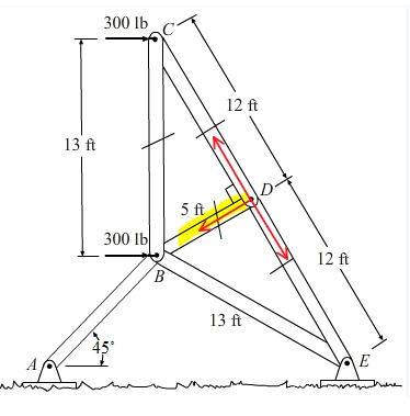

Can someone explain to me why that highlighted force is 0?
∑Fx = 0
I found FDC to be 780lb and I am still trying to solve for FDE
If BD was non zero, let's just say for example it was 100 pounds , then 100 lbs in the opposite direction would be required for equilibrium along that axis. Where would that required opposite force go?
