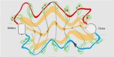

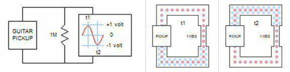

In this paper (http://science.uniserve.edu.au/school/curric/stage6/phys/stw2002/sefton.pdf) the author describes the transfer of energy in an electrical circuit as follows:
"To explain energy transfer we need to look at what is happening outside the wires. As a consequence of the surface charges on the wires, there is an electric field in the space outside the wires (as well as inside). Also, as a consequence of having a current in the wires, there is a magnetic field in the space around the wires. It is this combination of electric field and magnetic field in the space outside the wires that carries the energy from [source] to [load]. Once the fields are set up, the energy travels through space, perpendicular to both the electric field and the magnetic field, at the speed of light."
I've read similar descriptions in a number of places, often accompanied by a diagram showing the various fields that are participating in this energy transfer, like this:

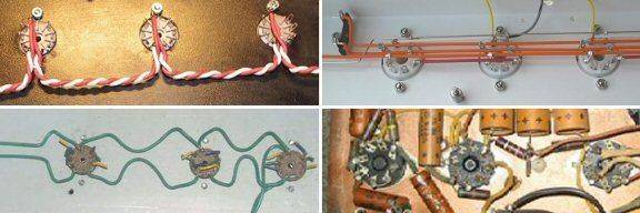

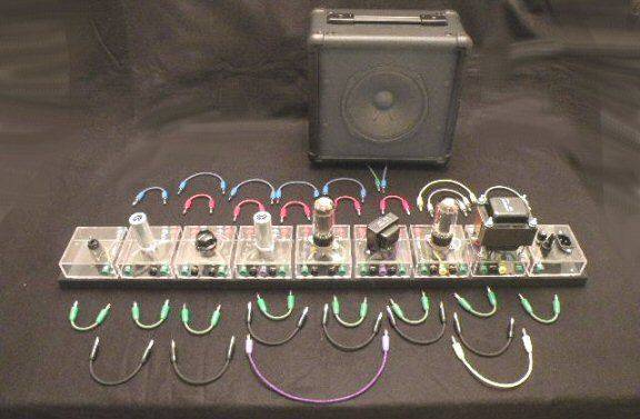

Now here are four photos of alternative layouts for the filament wiring in vacuum-tube amplifiers:
(The bottom right amplifier uses the chassis as one of the conductors in the filament circuit.) The total current carried by these wires is typically 2 to 3 amps, and the voltage (most often AC, but sometimes DC) is usually 6.3 volts. A similar variety of layouts can be found in the high-voltage portions of such circuits as well.
Now based on the diagram above, I would think the electric and magnetic fields in these various configurations would be significantly different. As different, perhaps, as the diagram above and, say, this one:
And yet I've found (in spite of the claims of various aficionados) no significant subjective difference in the performance of such widely different layouts; and certainly no objective difference in the voltage and amperage readings at the corresponding spots. Sure, we might get a little more or less hum one way or another (though, in practice, that's not as easy to predict as one might think); but we never see a significant change in the voltage or current based on the layout.
In other words, it seems to me that while these various fields may be truly present as described, it's hard for me to imagine that they are the primary conduit for the transfer of energy in such circuits. Seems to me that the energy is being transferred through the actual conductors (wires or chassis or both), not via the space surrounding those conductors.

If you calculate the fields in the last layout in detail, you'll get the same result as for the first diagram. The calculation is just much more complicated - a good argument why circuit analyses are always done with voltages and current flows in the conductors unless the circuit is designed for really high frequencies.
Why is that hard for you to imagine? Also, why does it matter?
How would you make an experiment to determine that? For example, have you even calculated how quickly the energy flux falls off outside of the wire to give you an idea of the spatial scales you have to investigate? Do you have a method for measuring energy flux that you could use inside and outside?
mfb said:
If you calculate the fields in the last layout in detail, you'll get the same result as for the first diagram. The calculation is just much more complicated...
I don't know about that because I don't know how to do the calculation (and haven't seen it done by anyone else). But I find it hard to believe that the size and shape of the fields are identical when in one case the wires are narrow and twisted around each other, and in another the entire chassis is employed as one of the conductors.
I do know that the theoretical intent behind twisting the wires (top left layout) is to neutralize those fields in the interest of minimizing hum -- and yet these supposedly neutralized fields somehow manage to transport the same amount of energy to the filaments!

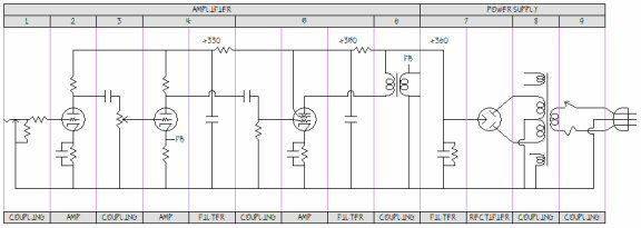

Here's another experiment we can perform easily enough. If you could roughly sketch out in bright colors -- or even describe in words -- the size and shape of the electric and magnetic fields in the four cases shown in black-and-white below, I think that would go a long way toward showing me how the difference in layout does not greatly affect the size and shape of those fields and thus does not greatly affect the transfer of energy via those fields.
Perhaps this will help. When I read practical engineering texts -- whether about filament windings or transmission cables -- I get the distinct impression that these fields around the wires are essentially unwanted side effects that we should strive to minimize (unless, of course, we're building an antenna); on the other hand, the physicist (like the above author) appears to be telling me that these fields are the essential and primary means of energy transfer. Can you see how this might confuse a beginner like me?
If you consider wires to be wave guides, this might make more sense. Use the Poynting Vector: S=ExH.
BTW, there is a measurable difference between the twisted path and the straight path. When you examine it with the complex poynting vector you will find the twisted path has significantly higher losses.
This all comes back to Maxwell's equations. Ohm's laws is a form of Maxwell's equations where some values are assumed and held constant, as are nearly all the formulas we use as electrical engineers. Thus we don't have to solve the field equations each time. But the field equations are still there, hidden by our simplified math.
So knowing this we can take a short cut to find the extra losses in twisted field path. That short cut is to measure the additional resistance that the longer wire provides and find the I2R loss. Suppose we made the path straight and used the same length of wire? We can't but we could add a loop at the end. Then the losses in the loop would match the losses in the twisting (neglecting inductance/capacitance which changes slightly with geometry).

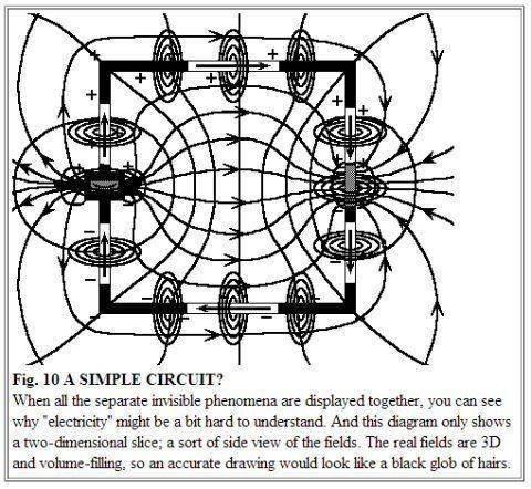

Welcome. We've had this discussion elsewhere about how to explain electrical energy in a physics compatible way to children. The 'shortcut' method is not an alternative to fields being the energy carrier. Ohms Law is just a simplification when the geometry of conductors including their physical lengths is small when compared to the electrical lengths so energy transfer is from reactive fields around those conductors not EM radiation into space between conductors. There are many ways to use analogy without forming misconceptions but I'm dubious that you will listen to the good advice here. Please prove me wrong.
How do novices and experts model electric current? Stocklmayer and Treagust (1996) in their study concluded that children coming into high school have a vague and often fearful image of electricity such as they see „a fire‟ or „a dangerous animal‟ as similes for electricity. Once they encounter formal circuitry they acquire a mechanistic model of electron movement through a wire which, by analogy and metaphor, is closely allied to fluid transfer. Teachers of electricity have a strong belief that the particulate model is both useful and „correct‟. They themselves hold these images, and few have a strong field concept. Clearly, however, their students have difficulty with the model and hold misconceptions and alternative conceptions about circuit behavior which lead to difficulties with problem solving. The electron-transfer model is ubiquitous: it appears in all texts in Australia whether they are designed for physics or engineering students or for electricians. Experts such as electrical engineers and lecturers in engineering and physics, however, do not retain this particulate imagery. They regard electricity as a field-like phenomenon, formed of endless loops. Their understanding is inextricably tied to the concept of electricity as useful energy. Their vocabulary deals with the task, the load, the job, and the field. They find the micro-view of electron transfer irrelevant and, at times, confusing.
http://versys.uitm.edu.my/prisma/view/viewPdf.php?pid=17159
To say "But there still appears to be a difference in perspective: are the fields the effect and the arrangement and movement of charges the cause? or it is the other way around?" is irrelevant as there is a synergistic effect in circuits where both are important to explain how the energy transfer system works as a whole in detail for source -> wiring -> load. The guiding and manipulation of electrical energy in fields is the reason we have circuits. A wire without EM energy is just a lump of metal, EM energy moving in space is just a wave. It's when we combine the two that cool things happen. To me that what you need to teach to young children. Focusing on one without the other is confusing when you look at it closely because it's a incomplete picture like explaining human reproduction with just the male or female half of the equation.
In AC circuits, the energy is in the fields. What the copper does is provide a place where currents can travel to make the fields.
Since the copper isn't a perfect conductor it "slows" the fields causing losses. It does this by slightly changing the direction of the resulting field so it is not completely parallel to the wire (in the math this is a complex/imaginary shift).
Some of the energy is directed to the wire rather than around the wire. That energy is lost as I2R heat. The amount lost depends on the amount of slowing which depends on how well the conductor can support the "eddy" current. (The words "eddy current" is usually used in magnetic type circuits and have some implications that this current doesn't, but the concept is similar.)

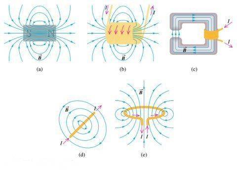

Here are three that I've come across.
Quoting from Merlin Blencowe's Designing Tube Preamps for Guitar and Bass: "Pairs of noisy AC wires (eg., mains and heater feeds) should be neatly twisted so the opposing magnetic fields around each wire are forced to occupy the same space, causing them to cancel each other out." So one thing that a particular layout can apparently accomplish is the neutralization of the magnetic fields around two wires.

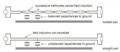

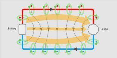

And here's a typical diagram explaining differences in transmission layouts:
So it seems a particular layout can also "cancel field induction" and "balance capacitances to ground."

Sure. The part that's a hard sell is the idea that the energy that powers our electric drill out by the tree-house is being transferred from the AC outlet, not through the 50-foot extension cord, but via invisible fields around the cord. Why? Because he knows everything around the cord is safe (it's those wires inside the cord we need to be careful with).
And I don't think it will become easier to sell after the kid has been introduced to diagrams of fields in various configurations like this:
Mainly because he's going to remember that drill by the treehouse and how it behaved exactly the same whether the extension cord was straight, messy, or wrapped up in a coil for storage.
Probably a book on guitars is not the best source for learning physics. This particular quote is simply wrong. You cannot neutralize the magnetic field by twisting two conductors around each other.
What you can do is to concentrate the magnetic field. It becomes less intense away from the twisted pair, but more intense between the pair. This concentration of the magnetic field, in turn concentrates the Poynting vector, meaning that a bigger fraction of the energy transferred flows through the fields between the pair rather than the fields around the twisted pair.
The conductor configuration with the most concentrated possible magnetic field is called a coaxial cable. It completely eliminates the magnetic field outside the conductors with no stray magnetic field at all. But there is still a very strong magnetic field between the two conductors. Thus there is still a place for energy to be conducted by the fields. Again, in even the most extreme conductor configuration, the magnetic field is concentrated, not canceled.
The observed behavior of a twisted pair or a coaxial cable is entirely consistent with the proposed idea that the energy is transferred through the fields around the wire. If it were transferred only through the conductor then the conductor geometry would make no difference.

Think of a steel ball on to of a cliff. The rock has energy because it is higher in the gravity field. Does that make the energy in the field? Or does the ball have the energy? That seems a philosophical question. To me the energy seems to be in the relationships.
Now suppose we attach the ball with some others to a two string pendulum. You have likely seen such a toy. If you drop one ball, the energy transfers to another. Again. is the energy in the balls, or the field? To me it seems to take both.
But unlike in gravity, in electricity there are two fields. One is electric and one magnetic. Energy can exist in the charges being higher in the electric field like the ball on a cliff. But it can also exist in a relationship between the electric and magnetic field without any steel balls (charges). We call these self supporting packets of energy photons. Since the energy can exist solely in the fields, but cannot exist solely in the charges, we tend to model the energy as being in the fields. (And remember electrons have little mass and move slowly, thus carry little energy under normal circumstances.)
Please try to understand Maxwell's equations. Understanding how a time varying magnetic field causes an electric field and a time varying electric field causes a magnetic field is essential for understanding electricity on the level you are trying to grasp.

DaleSpam said:
You cannot neutralize the magnetic field by twisting two conductors around each other. What you can do is to concentrate the magnetic field.
Seems to me (and apparently to Merlin) that it depends on exactly how the conductors are twisted. If the conductors are twisted in such a way that the fields are "in phase" with each other then yes, we would expect concentration; on the other hand, if they're twisted in such a way that they are "out of phase" with each other, we'd expect cancellation. In fact, this transmission line illustration specifically speaks of cancelled, not concentrated, induction:
I'm sure you can see the problem a beginner like me faces. Whom should I believe? Why?
OK, so show me the calculations. How exactly can one twist a conductor so as to cancel the field everywhere rather than concentrate the field somewhere? I don't know of any possible configuration of conductors that will accomplish this, but if you know "such a way" then by all means please present it.
Who you choose to believe is up to you. I typically don't choose to believe anyone. I prefer to learn the math so that I can either work it out for myself or follow someone else's math. Here is an example of the problem worked out quantitatively for a coaxial line: http://depa.fquim.unam.mx/amyd/arch...ia_a_otros_elementos_de_un_circuito_20867.pdf

Okay, folks, how about this (for explaining to the kid what happens at the pickup end of the guitar amp system):
1. We tell the kid that the pinkish dots represent globs of electrons flowing first one way, and then the other, when a note is struck on the guitar. And that these electrons change direction more frequently when the pitch of the note is higher, less frequently when the note is lower. And that we call this movement current.
2. Then we tell the kid that the curvy line he sees on the scope is tracking the voltage in the circuit. That the peak values at times t1 and t2 will be larger if the string is struck with more force, smaller if struck with less force. And when the kid asks what the blue dots represent, we look around to see who is listening in before replying:
(a) If a fan of the hydraulic analogy is around, we tell the kid that the blue dots are like greater water pressure; like a taller water tank feeding the bottom and top pipes at times t1 and t2, respectively.
(b) If a fan of the pneumatic analogy is around, we tell the kid that the blue dots are like air molecules which exert greater pressure when there are more of them per square inch of available area;
(c) If a fan of the Lamin's Loaf Lorrie Model is around, we tell the kid that the blue dots represent additional loaves that are being carried by the pink lorries for drop-off at the store labeled 1 MEG;
(d) If a fan of motional EMF is around, we tell the kid that the blue dots represent a excess electrons per proton; and
(e) If a fan of field theory is around, we tell the kid that the blue dots (which any idiot knows should have been drawn outside the conduits) represent waxing and waning electric and magnetic fields around the wires.
3. Then we sum up by saying that however he might picture it, the difference in the voltage across the resistor at any point in time will be equal to the opposition to the flow of current presented by the resistor (measured in ohms) times the amount of current that actually makes it through the resistor (measured in amps). And that the current will be very tiny in this particular circuit because the voltage is small, the resistance is very big, and the pink dots keep changing direction before they have much of a chance to get anywhere. And then we whisper in his ear: "The pink dots never really move very fast at all; but the blue dots almost always move at something pretty freakin' close to the speed of light."
How about that? Say "yea" and we can put this baby to bed. I'll work out the transformers and capacitors and the rest on my own.
  • #34
Perhaps using several analogies, while pointing out that they are analogies. When the child starts asking "why", tell her that's why math is so important.
You might add a slinky to help with understanding waves.
  • #35
Thank you for that post, it makes my decision to use a scientifically sound theory with my child even better for me. It also shows that fairy tales are easy to write but are hard to make consistent with reality.
