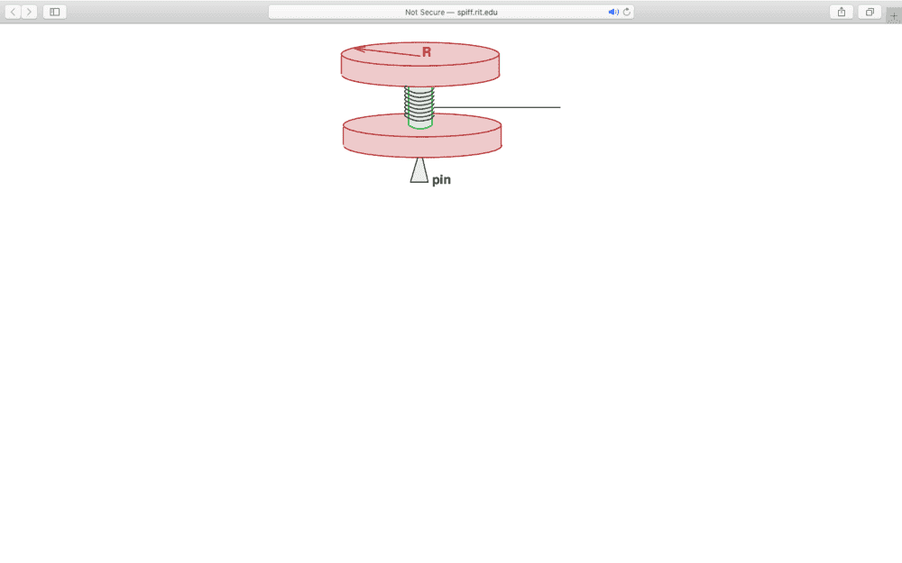

Joe has a simple yoyo, which consists of two disks, each of mass M=0.098 kg and radius R=0.144 meters, connected by a cylindrical spindle of mass m=0.016 kg and radius r=0.01 meters. Joe wraps some string around the spindle; it is made of rough fiber, so it will not slip as it winds and unwinds.
Joe places the yoyo horizontally on a workbench, as shown. He inserts a pin into a tiny hole in center of the bottom disk, so that the entire yoyo is free to rotate without friction around the pin.
What is the moment of inertia of the yoyo around the pin?
Fred now pulls on the string with a constant force T=5.2 Newtons. As he pulls, the string unwinds from the spindle and the yoyo starts to spin.
What is the torque exerted by the string around the pin?
What is the angular acceleration of the yoyo?
How long will it take Fred to pull the string a distance L=0.65 meters?
torque=|r|*|F|*sin(theta)= I * angular acceleration
total moment of inertia= (1/2) (0.098kg) ( 0.144m)^2 + (1/2) (0.098kg) ( 0.144m)^2 + (1/2) (0.016kg) (0.01m)^2
total moment of inertia= 2.03*10^(-3) kgm^2
torque= 5.2N * (0.144m) = 0.75N*m
thus: 0.75N*m= 2.03*10^(-3) kgm^2 * angular acceleration
angular acceleration = 368.8 rad/s^2
Is the work correct so far?

Looks like you have the string wrapped around the edge of a disk.
Is the torque just involves the cylindrical spindle thus :
torque= (1/2) (0.016kg) (0.01m)^2 ?
Did you mean that? You seem confused between torque and moment of inertia.
Likes tnich
That wasn't what I meant. I meant that you used the wrong lever arm in computing the torque. I think it would help you to see how to do it if you drew a diagram looking at the yoyo along the direction of the pin, showing the string and the outline of the disks and the spindle.
sorry about the mistake.
torque= 5.2 * 0.01 = 5.2 E-2
angular acceleration = (5.2 E-2)/ (2.03E-3)= 25.6 rad/s^2
I don't know how to solve for the time.
Through what angle will it have rotated?
90degrees
ac7597 said:
90degrees
How do you get that?
linear distance = radians * radius
0.65m= radians * 0.01m
radians= 65 rad
thus with kinematics:
65rad= (1/2) (25.6) *time^2
time=2.25 seconds
radians= 65 rad
time=2.25 seconds
Looks good.
