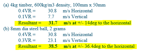

Hi, Can someone help with the below calculation. Sample attached
See Below
Top example- How do I get to 31.7 m/s from 30.8 and 7.7? This is way over my head and need help. Thanks in advance
Dean
##31.748 = \sqrt { 30.8^2 + 7.7^2 }##
It is the length of the hypotenuse of the right triangle formed by the horizontal and vertical numbers.
And the 14 deg is the angle off of horizontal that those two velocities make for the combined velocity.
## 14.03 = (180/\pi) * atan2(7.7, 30.8) ##
