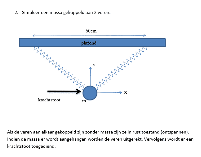

Hello my fellow scientists!
This is my first post on this forum, but most certainly not my last. I am relatively new to physics. I mean, i understand the basics. I would like to make it my hobby. You know, really find a passion for the physics. BTW, i am from the Netherlands, so please do not judge my grammer :)
1. Homework Statement
First, see the appendix.
If the springs are coupled with each other, Without the mass, the springs are at restposition. When the mass is applied between them the springs extend to a certain place.Thereafter a punch is applied to the mass in the X Direction.
I need to find the movement of the mass in both direction X and Y.
There is not much details given, i can fill this in for myself. Ofcourse i am assuming the simulation takes place on earth, with an acceleration g = 9,81m/s^2
Fs = Force Spring
Fg = Force Gravity
I have done this for a single spring/mass system under a angle of approximatly 45 degrees where a plate is also applied under an angle of 45 degrees so the mass doesn't fall straight down.
i am not sure which equations i need to apply. In this case. I need a start on this project so i can finish it on my own.
I am not sure where to begin in this project. I have done it before, but only with 1 spring and 1 mass under a 55 degree angle, with a bottom plate liniear to the spring and mass so the mass wouldn't fall straigt down.
But since there are 2 springs now its is a lot more complicated (in my opinion)
My question to you, can you please help me make a start on this project? I am not asking for you to solve this for me, but guide me trough it.
Thank you in advance!

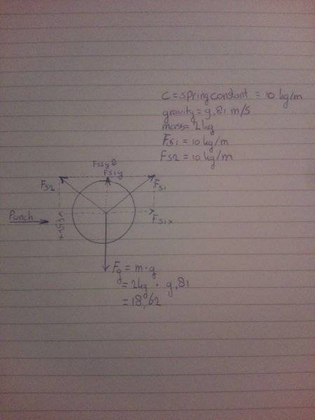

Thanks for your fast reply! It is indeed my intention to wire a simulation of the motion of the mass (i will do this in excel eventually).
I am working hard on a FBD, i will upload it when i have it figured out.

In either case, start by drawing the Free Body Diagram (FBD) of the forces on the mass at the equilibrium position, and then look at how those forces change as the mass moves vertically and horizontally from that equilibrium position. Can you make that start and show us your work?

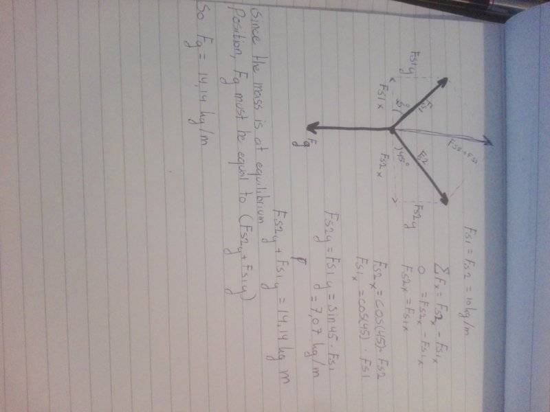

So here is my FBD. The two springs are the diagonal vectors(Fs2 & Fs1), and the gravity downwards is Fg
The constant of the springs are 10kg/m.
I divided the diagonal forces of the springs in there X component and the Y component. Fg has an Y component of 0 at the moment of rest.
So the resulting force in the Y direction is: Fry = Fg - (Fs2y+ Fs1y)
The resulting force in the x direction is: Frx = Fs2x -Fs1x
Fs1 = Force Spring 1
Fs2 = Force Spring 2
Fry = Force Resulting Y direction
Frx = Force Resulting X direction
Fs2x = Force Spring 2 X direction
Fs2y = Force Spring 2 Y direction
etc.Sorry for the metric units, i know you are used to the american units since you are in sillicon valley(?)

Seems like a good start. The directions and magnitudes of the spring forces will change with the (x,y) position of the mass, so that will all get factored into the simulation. I like that you are going to do it in Excel (at least at first), since I often do such initial simulations with an Excel spreadsheet. You will need to decide on a good time step value to use to give you good resolution (base it on an initial estimate of the resonant frequency of the system, and some target accuracy).
Can you say what the columns will be in your spreadsheet? :smile:

What is the significance of the 60 cm horizontal distance as shown in the figure? Is it fair to consider the following picture: There is a single spring of relaxed length 60 cm which is attached to two points on the ceiling. Then a mass is attached at its mid point (30 cm) mark and the mass is allowed to descend to its equilibrium position. Then a sharp impulse is delivered to the mass in the same plane as the plane defined by the extended spring. I am asking because I used google translate (it's getting better) and that's the impression I got. It also seems that you are asked to provide a simulation and not necessarily a solution. Is that correct?

It's not easy to read - too dark - but it looks like an FBD for the original position. You need an FBD for an arbitrary time later. There will be x and y displacements from that original position, leading to different angles and spring lengths. You will also need variables for x and y velocities and accelerations.
Next step is to write the ΣF=ma equations for the x and y directions.
Good job on the translation! You are almost right. Except that there is not a single spring of 60 cm connected to the ceiling, but the 2 springs are connected to each other, without the mass. So in my opinion by the weight of the springs they are probably not parallel to the ceiling but the point where they are connected is a little towards the ground. I am not sure, it is a little vague. I don't believe that this factor is that important?
Translation of the text from the first picture:
When the springs are connected to each other without the mass they are at their equilibrium position.(relaxed position).
If a mass is applied the springs will be stretched to a certain point. Thereafter a punch is applied.

Thank you kindly for your reply. Bij F=ma, F is force, m = mass, a = acceleration i assume?
Yes, and ΣF means the sum of all forces, i.e. the net force.

Since the mass is in its equilibrium position, the sum of all the forces must be 0. So Fs1x = Fs2x
And the same goes in the Y direction. But look! Fg must be equal to the sum of Fs1 &Fs2.
But when i calculate Fs1 +Fs2 the answer is, 14,14 kg/m. (The springs, Fs1 & Fs2 are the same, 10kg/m and the angle is 45 degrees)
What does this mean for Fz? How do i calculate Fz to make the answer 14,14?
In my opinion Fg = m(ass) * a(cceleration) = 2kg * 9.81 = 19,62. Am i doing something wrong?
EDIT: I just realized something when i was in the shower. The only value given in the assignment was the distance between the springs (60cm). The constant for the spring(10kg/m), the mass(2kg) and the angle of the spring(45 degrees), i declared them myself. But they probably must all be in proportion to each other. So for example i can declare the spring constant and the mass myself, but a specific angle comes with them. In that case i cannot declare the angle myself am i right? Another example, if a declare the spring constant, and the angle of the spring, a spicific mass comes with them. I cannot declare the mass myself?
So this means that F should equal (Fs1+Fs2).
That gives the next equation: Fg = m * a
14,14 = m * 9,81
m = 14,14 / 9,81
m = 1,44kg

The relaxed springs are 30 cm each. (
I know, but I don't want you to use any numbers. Just use the symbols m, g, k, L, h, and write the equations.

No, the springs are just as they are. Dont think to far

Height = √(Lspring2-302)
Mg = m*g
k = (m*g)-(Lstretched-Lrest)
Vertical force balance equasion: Fg = F1+2 Sum of forces in Y direction is 0 @ equilibrium(not sure if this is what you mean)
  • #31
Your simulation is not interested in equilibrium, so just define that position as your origin. Do as @haruspex advises and write out ##\vec F = m\vec a## equations in x and y
  • #32
Mg = m*g
A few errors there.
I defined L as the unstretched length, so use that, no numbers!
So the stretched length is √(L2+h2)
So how much is the extension? What is the tension? What is the vertical component of the tension?
  • #33
But h is unknown? In know h of 1 spring in vertical component is 9,81 m/s2 because total vertical component is 19,62 but i cannot use this to calculate the length of the stretched spring can i? Since thet have different units
  • #34
MrNewton said:
But h is unknown?
That's why we write equations containing unknowns, so that we can find out what they are. Just follow the steps in post #32. Don't worry for now about which are known and which unknown.
  • #35
Alright:
Extension = Stretched length - Length @ rest
Tension = -k * Extention
Vertical component of tension = SIN(theta)*Tension OR √(Heigth2+length@rest2)
With Theta i mean the angle between the spring and the ceiling.
