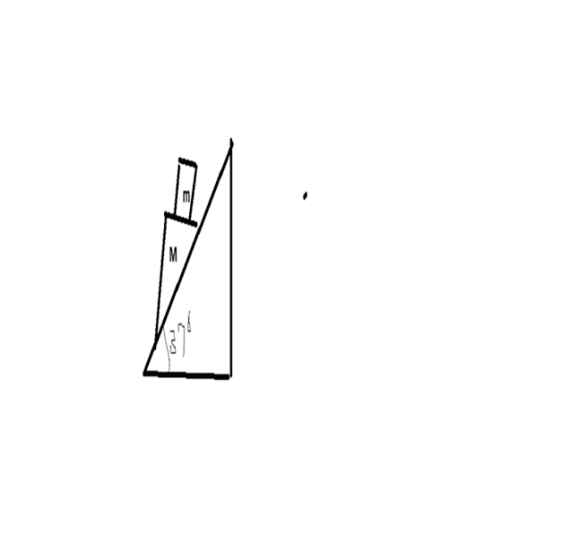

block M slides down on frictionless incline .Find the minimum co efficient of friction so that m does not slide with respect to M.
:acceleration of the system=total driving force/total mass:
[/B]
m does not slide with respect to M means there should not be kinetic friction rather static friction.both small and big block will have same acceleration.
acceleration of the system=total driving force/total mass:total driving force=(m+M)g sin theta
acceleration of the system=(m+M)g sin theta/m+M
=g sin theta
force responsible for acceleration of small block would be force of static friction between two blocks.
Hence force of static friction between two blocks=mass of small block i.e "m" multiplied by g sin theta
but this force of static friction between two blocks is also equal to or smaller than μ multiplied by normal force on small block i. mg
force of static friction ≤ μmg force of static friction/mg≤ μ
m× g sin theta= force of static friction
Hence m× g sin theta/mg ≤ μ
theta= 37 degrees
sin theta ≤ μ
sin 37 degrees ≤ μ
0.601 ≤ μ
but the correct answer should be 0.75 ≤ μ
where am I going wrong?

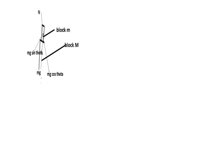

I think my diagram was wrong.Here I have corrected myself.

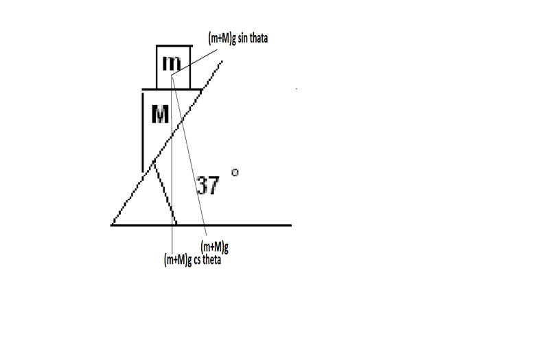

will (m+M)g sin theta act on both the blocks?
Your diagram is still awful. I thought I understood your original diagram. I'm still trying to figure out how to draw figures with whiteboard that can have straight lines. Meanwhile, please see if you can answer my questions in post #3.
I still don't know from your figure whether θ = 37° is the angle of the incline with the horizontal, or with the vertical. I assumed it was with the horizontal.

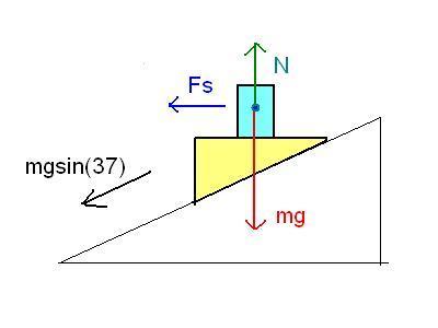

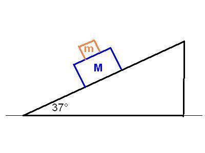

ehild said:
Is the set-up that shown in my figure?
Yes.Absolutely correct.
And is the problem text as you wrote? Is zero friction between M and the incline?

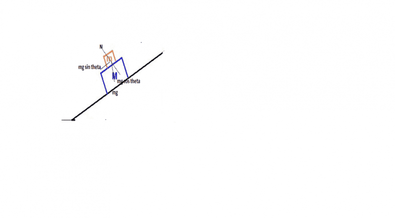

Please tell me is my free body diagram correct in post 5?I don't think so.Please point out my mistakes in post 5.
ehild said:
If you suppose zero friction between the blocks, what would be the acceleration of block m
Zero,as I think that it is the only net force acting on block m.
It is correct for the blocks as a single system, when they move together. To get the force of friction necessary acting on m you need to draw separate FBD-s for both blocks.
