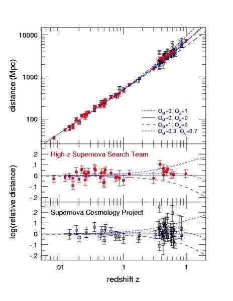

We can measure the redshift of distant Type Ia Supernovae to determine that the universe is accelerating. This chart here plots distance against redshift:
Hubble's Law for an expanding universe predicts a linear relationship - as distance increases, redshift increases. Without any increase in slope. However, if we look at the chart, we see that since z = 0.5 Hubble's Law is violated, and the slope is increasing. As marcus said, the SECOND derivative is positive. Expansion has been acceleration since z = 0.51, about 7 billion years ago.

What? Did you not read my post? The expansion has been accelerating since 7 billion years after the big bang. NOT since t = 0.
... We do see distant galaxies as they were few billion years after big bang. It's 7b y old information, faster expansion was 7b years ago, not now. We see no increase when we look 7b years around.

Yes we do! Did you not look at the chart? After z = 0.51, Hubble's law is violated.
