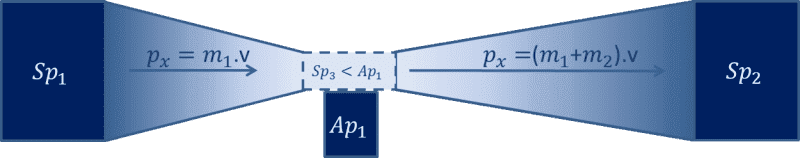

I was hoping to get a more complete understanding how a Venturi vacuum increases the Momentum of the fluid.
I know Momentum is an awful way to pose this question but it really is important that it can be explained by momentum instead of conservation - Hence the post.
An initial pressure difference Sp1 -Sp2 gives rise to fluid flow with a momentum px=mx.vx As the flow enters a constriction its flow rate vx increases and a consequential fall in static pressure Sp3 , this may even fall below Atmospheric SpA and this pressure difference SpA -Sp3 will cause mass m+ to flow into the pipe in the y direction.
As it exits the constriction reverting to original radius its velocity reduces to the mean flow rate vx induced via the pressure difference Sp1 -Sp2 However this velocity is now carried by additional mass so overall px=(mx+m+).vx increases
This increase in px is not paid for by the external x direction Sp1 -Sp2 pressure difference but by the y direction pressure difference SpA -Sp3
I know this does but I want to understand how the y direction momentum py induced by the y direction pressure difference contributes to x direction momentum ?
Can someone please explain the mechanism is transferred ? as to me the y direction pressure difference (being random) has equal chance to reduce x momentum as increase it.
Bonus points for explaining the 15' requirement
Are you sure that v2 = v1?
