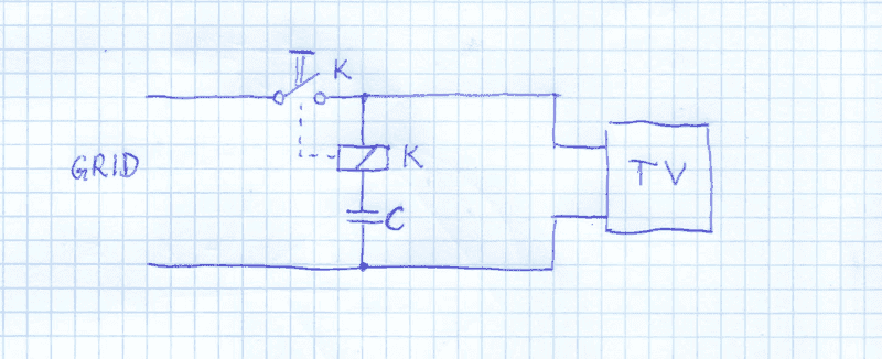

my electric supply company some time supply very low voltage which cause damage/burn out my Tv three time
do you know any sort of device which disconnect power supply to my Tv and my Tv un harm from low voltage my electric company uses 220 volt supply or british system.

The simple solution is to buy a relay that - when activated by hand - can just keep the contacts closed if the voltage is above say 210V.
Something like this:
Just adjust the value of the capacitor C so that the relay will be released by too low voltage.
You must "restart" the system by pressing down the contact by hand. You can buy some button as for this, to keep up safety.

dear Hesch,
do you know the actual name of this device or it is simply i ask to shop keeper to provide me under/over voltage relay protection switch please kindly tell me
thank you
Yes.
I think that the model in #5 is for 600V as the reference voltage, but of course they have other models for 115V and 220V as well ( factory tuned ).
In the link in #5 there are buttons/links like "where to buy", "questions" and so on.
Alternative you can consult an electrician. Maybe he has a relay in stock, that fits your voltage ( 220V ), or he can provide one.
The suggestion in #5 was just an example, there are a lot of undervoltage protection relays, some are more expensive ( with display and everything ), some are cheaper, as the one I suggested ( I think ).
To find alternatives, you can start here: https://www.google.dk/search?q=unde...-8&oe=utf-8&gws_rd=cr&ei=DiuNVeqLIYT7UKuwgaAP
The electrician can easily make some box, wherein to mount the relay, so that the installation will be safe and keeps to law.
