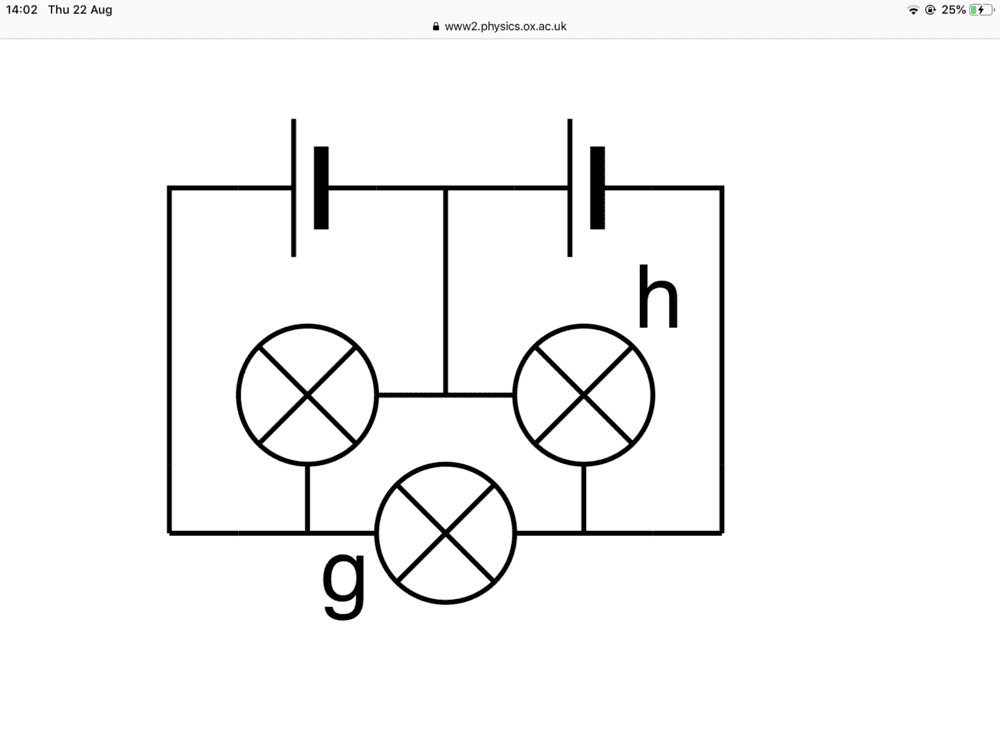

What is your idea? Have you tried redrawing the diagram, such that each bulb has it's own two wires, attaching somewhere to the line with the cells?cormzy said:Summary: Voltage received by each bulb in a circuit
How much Voltage does each bulb receive in the diagram below? (In terms of 1v being the voltage supplied by each cell)
I have have tried drawing 2 circuits for each battery, where two bulbs are in one parallel section and one bulb in the other.A.T. said:What is your idea? Have you tried redrawing the diagram, such that each bulb has it's own two wires, attaching somewhere to the line with the cells?
Hi A.T., is the top middle point at ##1V##? I see it's also connected to ground..A.T. said:What is your idea? Have you tried redrawing the diagram, such that each bulb has it's own two wires, attaching somewhere to the line with the cells?
