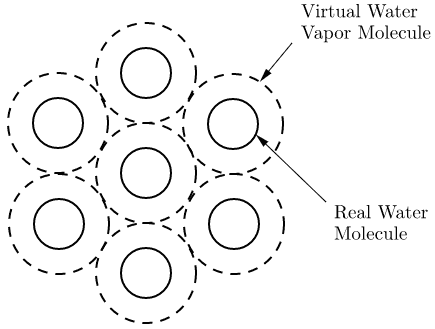

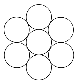

So, the water molecules having radius ##r_{m}## and volume ##V_{rm}## in the liquid state, as assumed, are arranged as shown in the diagram below:-
When the waster turns into water vapor then, let's assume that there are virtual water vapor(cocentric with the original ) molecules touching each other, having radius ##r_{vm}## and volume ##V_{vm}##. So, the water vapor molecules would look like this:-

Since from the answer of Problem 1, we have
$$V_{vm}=\dfrac{1}{6\times 10^{-4}}V_{m}\implies V_{vm}=\left(1.67\times 10^{3}\right)V_m\\
\implies V_{vm}=\frac{3\times 10^{-29}}{6\times 10^{-4}}=5\times 10^{-26} \text{m$^{-3}$}$$
So, we get the radius of the virtual molecule of water as ##r_{vm}=\sqrt[3]{\dfrac{V_{vm}}{\frac{4}{3}\pi}}##
$$\therefore r_{vm}=2.28\times 10^{-9}\text{ m}\approx 20 Å$$
As each real molecule is located on the periphery of the circle described by the sphere created by the virtual water vapor molecule, hence the interatomic distance in vapor b/w the water molecules can be approxiamted to ##r_{vm}=20Å##.
But my answer does not math with that given in the solved problem. The answer of the solved problem is ##40Å##.
Solution provided by the book:-
A given mass of the water in vapor state has ##1.67 \times 10^3## times the volume of the same mass of water in liquid state. This is also the increase in the amount of volume of each molecule of water. When volume increases by ##V^{1/3}## or ##10## times, i.e. ##10\times 2Å=20Å##. So the average distance is ##2\times 20Å= 40Å##.

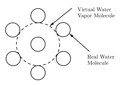

So what the book assumes the model of the molecules of water in gaseous phase is as follows:-
So what is wrong in the arrangement of the molecules in the gaseous state that I proposed, and why is the books model correct.

Doesn't every real molecule have to be contained within a virtual molecule? And if so, doesn't that make the distance greater than one radius of a virtual molecule?
That seems to be the case as the book has adopted that pathway to arrive at the solution but it doesn't appear to be the right method to me at the moment. Perhaps you can reason with me as to why is the book's assumption correct.
Well, the radius was calculated from the volume of a virtual molecule. But in your picture, you have 6 real molecules and only one virtual molecule. So by using 6 real molecules and 1 virtual molecule you have created a different density than what you started with. In other words, by using the molecules as you have shown, more molecules will now fit within a given volume. Another way to word the question: Why is that one molecule allowed more volume than the other 6?

I agree with Tom.
The question itself is a bit misleading though. How is one to define the average distance between the molecules? Taken literally, it would be about equal to the radius of the volume containing the water vapour. It must be more in the sense of nearest neighbours, but in practice they won't be so evenly spaced as in the model. There is a way to work that out, and the answer is rather different.
