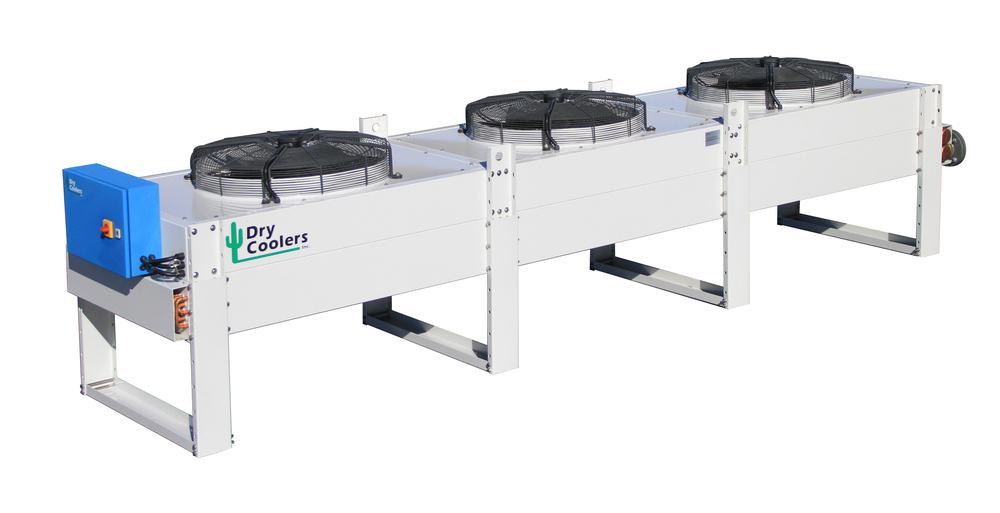

You need a cooling tower or dry cooler if you don't have access to a large heat sink (a pool or lake?).
You can make a dry cooler with a car radiator.
Likes Klystron, berkeman and Anon_Miner

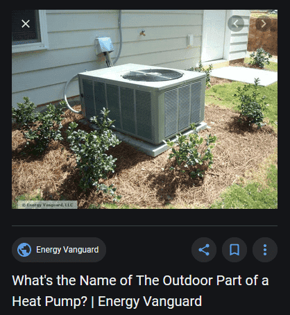

Also, you might look at re-purposing the exterior fan and housing of a heat pump -- it's a nice compact weatherproof unit that you could use to pull air through your radiator...
Likes Klystron, russ_watters and Anon_Miner
