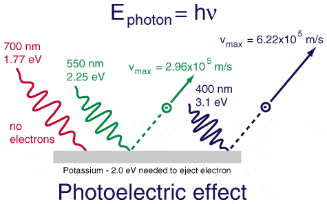

When I milked a dinosaur the milk came in packets. No, seriously, you've got good answers above - Planck's work on blackbody radiation and the photoelectric effect. Here are some additional pages which might be helpful:
Problem 1: Blackbody Radiation (The problem - the "ultraviolet catastrophe")
Solution 1: The Planck Hypothesis and Photons: The Quanta of Light
Problem 2: The Photoelectric Effect (The problem)
Solution 2: The Photoelectric Effect (The solution)
The Photoelectric Effect (image):
I hope it's helpful. If you got further questions, don't hesitate to ask!
