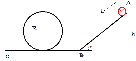

An empty ball , of mass m moment of inertia I = (2m.r²)/3, is rolling across the path shown below :
there is friction fr from A to C .
r is the radius of the ball , and R is the radius of the circular part within the path .
what would be the minimal height h , so that the ball can make a complete lap in the loop (the circular part) ?
∑F = m.a
∑τ = I . α = r.I.α / where α is the angular acceleration , I the moment of inertia , and r the radius .
after some computations I've found :
[tex]a_{T} = \frac{g.\sin(\alpha)}{\frac{2}{3}r^{2}-1}~~[/tex] ( a_T ; is the translational acceleration)
[tex]f_{r} = \frac{2m.g.\sin(\alpha).r^{2}}{2r^{2}-3}[/tex]
I know that the ball must roll on a distance of 2πR( the perimeter of the loop). But I can't figure out how to link between the acceleration and this distance ?[/B]
picture link : https://i.imgsafe.org/38bb5dc5ca.png

This statement troubles me. Taken at face value, it is referring to static friction (the ball is rolling, we're told), but if so it is irrelevant what the value is, and it would not be the same on the slope and on the flat (where it would be zero). So I suspect it means rolling resistance, which will act as a constant force opposing forward motion.
Either way, should not need to get involved in details of accelerations. Use energy considerations.
Your expression for the acceleration cannot be right anyway. It is dimensionally inconsistent (r2 and 1 being added/subtracted).

when the ball is on the loop , there is gravitational force friction , and reaction force , they have also sad that the reaction force was zero on the top of the loop , in addition to that , they give a hint which says that we have to use Newton's law to find out the relation between the velocity (translational velocity to be more precise) and the gravity g . now , what I'am wondering is , do the acceleration in the inclined plane have anything to do with loop , I mean can we study the motion of the ball just inside the loop regardless of the inclined path before ?
Yes. All that matters for the loop is that it enters with sufficient speed. Having found that, you can work backwards to the ramp.
but how to find this minimum velocity ?? any hints ?
What forces are acting on the body at the top of loop? Try to write down their equations

You can use energy to get speed (it will be related with initial height)at one point inside de loop and then from that point Newton's equations. Don't forget rolling energy.
By using conservation of mechanical energy energy :
[tex] m.g.h=w(f_{r})+\frac{1}{2}m.v^{2}+\frac{1}{2}I.\omega ^{2}=-f_{r}.\frac{h}{\sin(\alpha)} + \frac{1}{2}m.v^2+\frac{1}{3}.m.v^{2}=-f_{r}.\frac{h}{\sin(\alpha)}+\frac{5}{6}m.v^{2}[/tex]
[tex]g.h = \frac{5}{6}.v^{2}-f_{r}.\frac{h}{\sin(\alpha)} [/tex]
I am not sure how you obtained these, but they are wrong. As was already pointed out, it is of primary importance to check if the units are consistent when you obtain a formula, and in your equations they are not.
And you can't just neglect the loop vincular reaction because it is what makes the circular motion possible(it is a centripetal force).
I'd suggest you to post the original text to overcome this and other ambiguities, like the frictional force you are talking about.
As haruspex already pointed out it may be a static friction, thus making the motion a "pure rolling", or it could be a rolling friction.
In the first case(which i think is the right one), it would not be relevant since it is static and making no work, so conservation of energy applies; in the second case you would have dissipative forces on the plane but probably not on the loop(i don't think the dynamics of a loop with rolling friction can be solved analytically).
Anyway, to correctly apply energy conservation you need to account for the centripetal force(which, if you don't remember, depends on velocity). If your body reaches the top with 0 speed, it will not make a complete lap but just fall down under the action of gravity.

Please, let's take this in easy steps. First, what are the vertical forces acting at the top of the loop? What is the vertical component of acceleration at the top of the loop? What equation does that give?
ok , on the top of the loop we have :
the vertical accleration which is tangential to the loop : [tex] a_{x} = \frac{v^{2}}{R} [/tex]
and the normal accelration which points downward : [tex] a_{y} = m.g [/tex]
is it right ?

That highlights an unreality in the question. It says there is a constant frictional force all the way. As I keep pointing out (and mamadou ignores) they mean rolling resistance, not friction, but either way it should be proportional to normal force. The normal force changes from ramp to flat, and continuously around the loop.
If we just accept that the question wants us to assume assume there is a constant force f opposing linear motion, we can do that. But it means we might as well take that to be true at the top of the loop also, even though there is no normal force at all. We will be taking f as constant everywhere else in the loop, and it will make no difference whether we take it to be 0 or f at the very top.
Anyway, @mamadou, do you understand that the only radial force at the top will be mg? What F=ma equation does that allow you to write?
