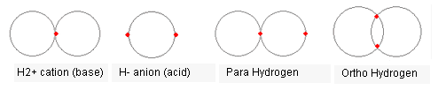

To me it is meaningful in a goal to model or simulate processes such as hydration and polymerization where you must track things over time. The model of electrons stuck inside a shell by an amount equal to their ionization energy, together with the normal coulomb force pushing protons apart, leads to the most common forms of hydrogen that are easy to draw and conceptualize (is there a spell checker in this application?).
