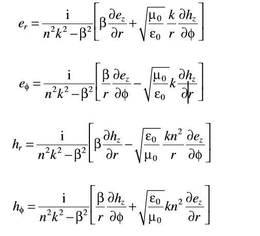

İf possible, could you look a book named by Fiber Lasers, Basics Tech and App's. In this book page 12, you will see the equations set in polar coordinates for Maxwell equations.
Maxwell Equations set in polar coordinates:
My homework is by using Maxwell equations in polar coordinates, to reach this Picture. But i did, what you said. I wrote the determinant. But i could'nt find. Could you use maxwell equations ∇ x E and ∇ x H till this Picture, step by step.
Thanks!

can someone help?
This entire thread is VERY confusing.
The title of the thread asked about the curl of E in cylindrical coordinate, which should be trivial to write (https://www.chegg.com/homework-help/definitions/divergence-gradient-and-curl-in-cylindrical-coordinates-2). But then, the body of the thread is asking about polar coordinates and writing its determinant?! It is cylindrical, or is it polar?
And are you asking how for cylindrical coordinates, or spherical polar coordinates? Make up your mind.
And forget about taking the curl of anything. Do you know how to use the determinant method to find the cross product of two vectors in the first place?
BTW, just for reference, this is all math, not physics.
Zz.
Likes tornado and berkeman
can someone help?
in cylindrical coordinates not polar. just book says its in polar coordinates
In my judgment, the easiest way to do this is to start out with the expressions for the del operator and the electric field strength vector in cylindrical coordinates:
$$\boldsymbol{\nabla}=\mathbf{i_r}\frac{\partial }{\partial r}+\mathbf{i_{\theta}}\frac{1}{r}\frac{\partial }{\partial \theta}+\mathbf{i_z}\frac{\partial }{\partial z}$$and
$$\mathbf{E}=E_r\mathbf{i_r}+E_{\theta}\mathbf{i_{\theta}}+E_z\mathbf{i_z}$$
So, $$\boldsymbol{\nabla}\boldsymbol{\times}\mathbf{E}=\mathbf{i_r}\boldsymbol{\times}\frac{\partial \mathbf{E}}{\partial r}+\mathbf{i_{\theta}}\boldsymbol{\times}\frac{1}{r}\frac{\partial \mathbf{E}}{\partial \theta}+\mathbf{i_z}\boldsymbol{\times}\frac{\partial \mathbf{E}}{\partial z}$$So, what do you get for ##\frac{\partial \mathbf{E}}{\partial r}##, ##\frac{\partial \mathbf{E}}{\partial \theta}##, and ##\frac{\partial \mathbf{E}}{\partial z}##?
