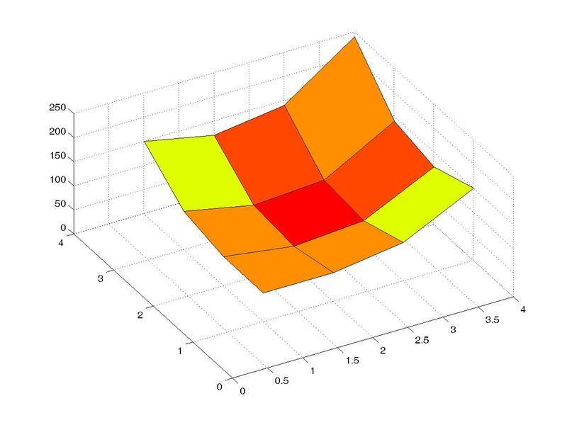

Thanks guys - I have now got the following code, so near yet so far:
x = [1 2 3 4 1 2 3 4 1 2 3 4 1 2 3 4];
y = [1 1 1 1 2 2 2 2 3 3 3 3 4 4 4 4];
x = reshape(x,4,4)
y = reshape(y,4,4)
z = [30 20 20 30 20 10 10 20 20 10 10 20 30 20 20 30];
z = reshape(z,4,4)
z = (z.*x + z.*y);
surf(x,y,z)
colormap hsv
axis([0 4 0 4 0 250])
to generate the attached plot (see below)
The plot is not what I want! I want 16 squares the 4 corners to be the same value, the 4 middle ones to be the same value and the rest a third value - as indicated by the z matrix. I am not bothered about the actual values i.e the 4 corners do not have to be 30 I am more interested in the weighting between each of the 3 values.
Regards
Tom
You are getting a distorted curve because of this line.
z = (z.*x + z.*y);
Take out this line and the code should work. Don't get hung up on making z a function of x and y. It won't work because z has no analytic dependence on x and y, thus you need to manually specify the values of z at each coordinate (which you have already done).
Claude.

Although my matrix (coloured part) is still 3 x 3!

It's 3x3 squares, but 4x4 coordinate points - as you specify.
