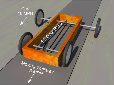

There is an easy way to understand the feasibility of the upwind cart.. That's to understand that individual blades of the prop do not move directly upwind. They are "tacking" in 3D.
This is true as well - and is true of both the upwind and downwind cart. In fact this is how I originally conceived of the downwind cart (though it turns out I was not the first to do so).
To understand that the blades are on a continuous helical tack, it's of course important to understand that their gearing to the wheels replaces the constraint that would otherwise be provided by the keel of a sailboat.

What causes the cart to reach a maximum speed? If the faster it goes the more wind it 'feels', is there a limit to how fast a craft could eventually reach?
  • #33
r-j said:
There's something I rarely see. ;)
The advance ratio between the rotor and the wheels sets the hard theoretical limit.
For instance, in the downwind case, a propeller pitched and geared to advance half as far through the air as the wheels go over the ground, will be limited by that to twice wind speed. Of course, since a propeller can never achieve "hard gearing" with the air to do that (there will always be "slip"), the limit will be less than that. An example of a very similar situation is:
But in real terms, it is mostly aerodynamic drag force, as well as the other efficiencies, that catches up to the the thrust force and prevents further acceleration.
  • #34
The vehicle has a "design speed" given by the turbine pitch and gearing. This is what we call the "vehicle speed ratio" (VSR). It's the rate at which the turbine would advance through the air divided by the rate at which the wheels advance over the ground - keeping in mind the two are connected by a transmission.
If that number is greater than 1.0, you have a vehicle that can theoretically go directly into the wind faster than the wind. If it's less than 1.0, you have a vehicle that can go directly downwind faster than the wind. The closer you get to 1.0 from either side, the greater a multiple of wind speed you can theoretically achieve (this can be worked out through simple kinematics).
But... the closer you get to 1.0, the greater the required efficiency needed to make the vehicle work at all at that VSR. You can change the VSR by changing the gearing or the prop/turbine pitch. With the Blackbird, we do have the ability to change the prop/turbine pitch on the fly. We can change the gearing, but only while stopped.
That being said, there is no theoretical limitation on maximum multiple of wind speed. It's just a matter of building a vehicle with high enough efficiency - and operating in a low enough wind.
The reason you need to operate in a low wind if you want to achieve very high multiple of wind speed is that you start fighting compressibility effects of air at higher speeds. This will inherently reduce your efficiency, and therefore limit your multiple of wind speed.
