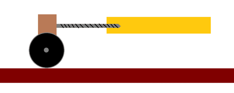

Yeah, there seems to be many very intuitive ways to understand this. For me I just instantly started to think about two objects, like a rope moving inside a pipe, and thinking whether it would be possible to latch on to the rope, press a wheel against the pipe, and then gain leverage to move faster than the rope. The answer is very obviously yes.
But clearly different people have different kinds of intuitive sense, so what works for one person might not work for another. I think the biggest obstacle some people have must be that they simply try to convince themselves for reasons to not have to think about this further, and that escape is offered by the thought "no matter how you cook wind momentum, you can't turn it into faster speed", which as we know is patently false.
So that's why when you say the magic word "leverage", it does nothing because it sparks no motivation to think about the system.
On that topic, I attached a picture of yet another very simple way to think about the fact that no laws of physics are being violated. It's a long screw that is driven by a wheel. As soon as the screw is partially inside the wood beam, surely it's possible to push the wooden beam along, and have the wheel roll against a ground in such a way that the screw is moving faster than the wood beam.
It should be pretty obvious that that is analogous to gaining leverage from the momentum between two mediums. And it should be obvious that it must be physically possible for the screw to indeed push into the wood. And it should be obvious that propellers and screws are quite similar - there's just more slippage for the propeller. But that should not be a problem when we discuss about the theoretical possibility of moving faster than the medium you are "powered by" (in semantical sense).
