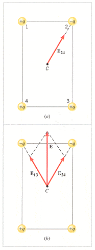

The magnitude of each of the charges in Figure 18.21 is 9.40 10-12 C. The lengths of the sides of the rectangle are 3.00 cm and 5.00 cm. Find the magnitude of the electric field at the center of the rectangle in Figures 18.21a and 18.21b.
I know figure a is 198.22, but I can't seem to figure out b.

You need to calculate the fields separately, then add them like vectors. Then you can find the magnitude of the resultant. An easy way to do this is to get the magnitude of each electric field, then find a unit vector that points from the center to the charge in question. Then you can multiply the magnitude by the unit vector and voila, you have the electric field vector.

As for the first problem I assumed that the Fy would equal the total magnitude, (198.22 cos 45) x 2.
What's Fy?
Fy = F in the Y direction. The Force along the x axis, Fx, will cancel out as the two forces are equal in opposite directions.

The problem doesn't ask for any forces. It asks for the electric field. But you are correct in saying that the horizontal components cancel.
So try to follow these steps:
1.) Calculate the magnitude of each of the 4 electric fields using:
E=\frac{kQ}{r^2}
2.) Compute the unit vectors pointing from the center to each of the 4 corners of the rectangle. Since you have correctly observed that the net electric field has no x component, it should be clear that you really only care about the y-components of these unit vectors.
3.) Multiply each E-field magnitude by its corresponding unit vector.
4.) Add them up.
5.) Find the magnitude.

Hi, I'm working on a problem identical to the first question posted, and I'm on part B. I am having a whole lot of trouble figuring out what the resultant vector E is.
Here's what I've attempted thus far, oy:
a) First, I did as Mattson suggested and found the vertical components of the charges. I multiplied them by four (since the resultant is a combination of the four, right?) and my answer was incorrect.
b) Then, I did the good old 30-60-90 calculation, just because I was getting frustrated. It gave me the same answer as A, and it was incorrect.
I've done a million things and seem to end up at the same, incorrect number. I'm very frustrated, please help? Thanks.
