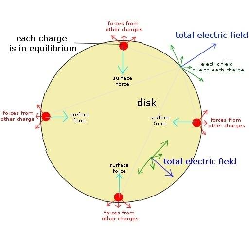

In fact an electron on the surface might experience no net force (in equilibrium) but still produce a field of its own in its vicinity. So equilbrium of electrons does NOT imply zero electric field around them.

Imagine just 4 electrons in a circular disk. They'll form a square. Each will be in equilibrium. But in the vicinity of each electron the e-field will be non-zero. Shall I draw a diagram and calculate the e-field somewhere in the middle between electrons, on the surface?

Then I'll have to draw you a diagram of 4 electrons in a circular disk. Diagrams are so much easier to clarify things.
