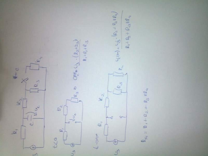

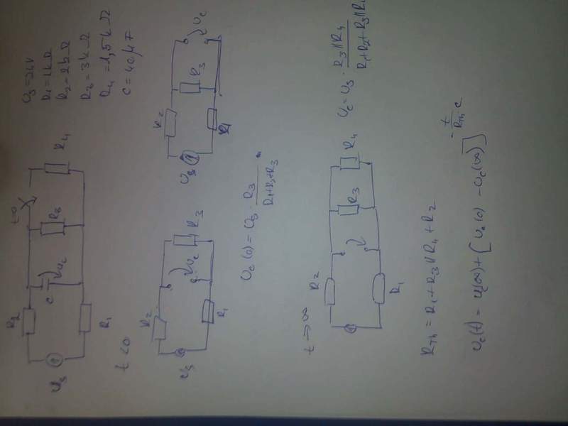

Hi, I have a simple question: if I have a circuit with a capacitor, how do I calculate the voltage on the capacitor in function of time, I mean I know that tau(τ)=RC and there is the general formula X(t)=X(0)+[X(0)-X(∞)]-t/τ. So here comes my question should I consider the capacitor as the load and calculate the Thevenin equivalent voltage at t=0 and t=∞ and use the X(t)=X(0)+[X(0)-X(∞)]-t/τ forumla ,where τ=RThC.
You can do it that way. A simple "rule of thumb" is that a capacitor is a short for high frequencies (t=0) and an open for DC (t=infinity).
Ok, I have some circuits and I don't know if I resolved the problems right so here are they:
and I have another question: files
