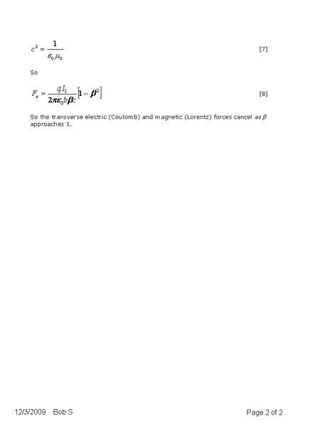

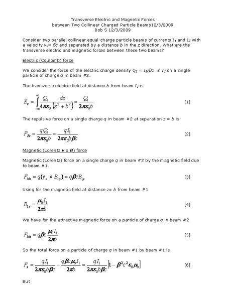

I attach a calculation showing that for two parallel equal-charge particle beams, the repulsive electric (Coulomb) force and attractive magnetic (Lorentz) force cancel as the particle velocity v=βc approaches c.
Bob S

Thanks for putting that together, Bob S. Having the calculation to look at helps me to interpret what you are saying better. The only 'extremely relativistic' case where the forces actually cancel is REALLY EXTREME. When beta=1 and the speed of the beams is actually c. So in any physical case where beta<1 then the Coulomb force is actually dominant. So it doesn't contradict the picture in the rest frame of the beams where there is only a Coulomb force and the beams diverge. In ANY frame, the beams diverge but more slowly as the velocity increases. In the lab frame you attribute this to a growing magnetic force between the beams. But you can also interpret this in the lab frame by computing it in the beam rest frame and then saying the divergence is slowing because of time dilation. Agree with that?
