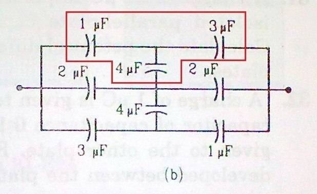

This was a ques in my book ... (Pic)
After thinking a while, i realized that it can be solved using Y-Delta (by converting Y to delta form) conversion. But i couldn't get the answer ... i don't know why ...
I used this http://en.wikipedia.org/wiki/Y-%CE%94_transform"
It is given for resistors ... i guess its same for resistors and capacitors ... Right?
Please tell me if the eqn used is wrong or something else!

Remember how capacitors combined differently in series and parallel than do resistors?
What you can do is convert all your capacitances to their equivalent impedance, then use those formulae. Impedances mix and match like resistances.

Zc = 1/(j\omega C)
\omega is the operating frequency. The result is in Ohms, and will be an imaginary value.
Don't panic! You don't need to know the frequency for the math to work out; it's a constant for the given Y to Delta situation. If you do the algebra, a pretty simple result obtains. If the resistor version is:
Ra = (R1*R2 + R2*R3 + R3*R1)/R2
Rb = (R1*R2 + R2*R3 + R3*R1)/R3
Rc = (R1*R2 + R2*R3 + R3*R1)/R1
Then the capacitor version looks like:
Ca = C1*C3/(C1 + C2 + C3)
Cb = C1*C2/(C1 + C2 + C3)
Cc = C2*C3/(C1 + C2 + C3)
And to find Y form,
C1 = (CaCb + CbCc + CcCa) / Cc
Right?

Right.

The three capacitors enclosed in red form a Y. So does the other set of 1, 3, and 4 μF capacitors. Converting each of these sets to Δ configuration, as shown by gneill above, will allow you analyze the circuit as a combination of parallel and series capacitors.
