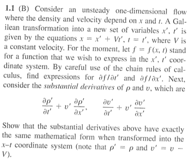

So we have that [itex]f = f(x,t)[/itex] as well as the transformations [itex]x = x' + Vt'[/itex] and [itex]t = t'[/itex]
By the chain rule:
[tex]\frac{\partial{f}}{\partial{t'}} = <br /> \frac{\partial{f}}{\partial{x}}\frac{\partial{x}}{\partial{t'}} +<br /> \frac{\partial{f}}{\partial{t}}\frac{\partial{t}}{\partial{t'}}[/tex]
[tex]\Rightarrow<br /> \frac{\partial{f}}{\partial{t'}} = <br /> \frac{\partial{f}}{\partial{x}} * <br /> \left [ \frac{\partial{x}}{\partial{t'}}+V+t'\frac{\partial{V}}{\partial{t'}}\right ]<br /> + \frac{\partial{f}}{\partial{t}}\frac{\partial{t'}}{\partial{t'}}[/tex]
[tex]\Rightarrow<br /> \frac{\partial{f}}{\partial{t'}} = <br /> \frac{\partial{f}}{\partial{x}} * <br /> \left [ \frac{\partial{x}}{\partial{t'}}+V+t'\frac{\partial{V}}{\partial{t'}}\right ]<br /> + \frac{\partial{f}}{\partial{t}}[/tex]
Not really sure what the next move is? Is the above equation in its simplest form? Or can I do something more with it?
Also, I don't really see how I go about transforming [itex]\rho'[/itex] and [itex]v'[/itex] into the x-t coordinates?
Note that there are only partial derivatives.
So then isn't
[tex]\frac{\partial x}{\partial t'} = V[/tex]?
You made a mistake:
[tex] \frac{\partial f}{\partial t'}=V\frac{\partial f}{\partial x}+\frac{\partial f}{\partial t}[/tex]
as:
[tex] \frac{\partial x}{\partial t'}=V\quad\frac{\partial t}{\partial t'}=1[/tex]

Shouldn't that be [tex]\frac{\partial f}{\partial x}[/tex]?

Now you put in ∂x'/∂t etc, which you can read off the Galilean transformation. :smile:
But the question tells you that … ρ' = ρ, v' = v - V. :confused:
