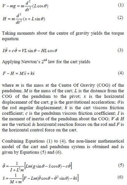

How are equations used to derive the final solution in this image?

In the attached image, how are equations 1, 2, 3 and 4 used to come to the final equation of 5 and 6? I am suspecting it has something to do with the derivative with respect to t, but I don't know how they remove it to get the final solution. Am I missing something incredibly simple that is not worth mentioning in the text?
The image was taken from http://www.r8sac.org/files/SPC/bugeja.pdf if further information is needed.

I understand it correctly now and i have the matching answer but with one tiny problems..
If you look at equation 5 and 6they have a multiplyer at the front being 1/(I+L^2m) and 1/(M+m) respectively
however, when in my answers they are simply 1/I and 1/M respectively as that is what the rearranged equations 3 and 4 give.. I did not get any division from chain/product rule that can give this answer...
Do you know how they derived the I+L^2m or M+m on the numerator ??

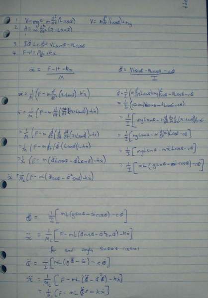

it would be faster if i just took a photo of my working
I changed the variable of M to Mc to ensure i wasnt getting mixed up with m. They are two different masses. A little messy but you can see how i got 1/I and 1/M...

in your left-hand column (the x'' equation), you've lost the extra x'' terms between lines 4 and 5
in your right-hand column, a lot seems to have gone missing …
it would be easier to check if you would type it out :redface:
The two equations:
F-H=M\ddot{x}+k\dot{x})
H=m\frac{d^{2}}{dt^{2}}(x-Lsin(\theta))
Derivation:
\ddot{x}=\frac{1}{M}(F-H-k\dot{x})
\ddot{x}=\frac{1}{M}(F-m\frac{d^{2}}{dt^{2}}(x-Lsin(\theta))-k\dot{x})
\ddot{x}=\frac{1}{M}(F-m\frac{d}{dt}(\frac{d}{dt}(x+Lsin(\theta)))-k\dot{x})
\ddot{x}=\frac{1}{M}(F-m\frac{d}{dt}(\frac{d \theta}{dt}\frac{d}{d \theta}(x+Lsin(\theta)))-k\dot{x})
\ddot{x}=\frac{1}{M}(F-m\frac{d}{dt}(\frac{d \theta}{dt}(Lcos(\theta)))-k\dot{x})\ddot{x}=\frac{1}{M}(F-m\frac{d}{dt}(\dot{\theta}Lcos(\theta))-k\dot{x})
\ddot{x}=\frac{1}{M}(F-m\ddot{\theta}Lcos(\theta)+m\dot{\theta}\frac{d}{dt}(Lcos(\theta))-k\dot{x})
\ddot{x}=\frac{1}{M}(F-m\ddot{\theta}Lcos(\theta)+m\dot{\theta}^{2}\frac{d }{d\theta}(Lcos(\theta))-k\dot{x})\ddot{x}=\frac{1}{M}(F-m\ddot{\theta}Lcos(\theta)-m\dot{\theta}^{2}Lsin(\theta)-k\dot{x})\ddot{x}=\frac{1}{M}(F-mL(\ddot{\theta}cos(\theta)-\dot{\theta}^{2}sin(\theta))-k\dot{x})
The text says it should be:
\ddot{x}=\frac{1}{M+m}(F-mL(\ddot{\theta}cos(\theta)-\dot{\theta}^{2}sin(\theta))-k\dot{x})
the same issue is with the theta double dot. So what ever i am doing wrong here is the same issue with theta double dot. I will type the theta dot out in the next post
The Two equations:
V-mg=m\frac{d^{2}}{dt^{2}}(Lcos(\theta))
I\ddot{\theta}+c\dot{\theta}=VLsin(\theta)-HLcos(\theta)
Derevation:
\ddot{\theta}=\frac{1}{I}(VLsin(\theta)-HLcos(\theta)-c\dot{\theta})
V=m\frac{d^{2}}{dt^{2}}(Lcos(\theta))+mg
V=m\frac{d}{dt}(\frac{d}{dt}(Lcos(\theta)))+mg
V=m\frac{d}{dt}(\frac{dx}{dt}\frac{d}{dx}(Lcos( \theta)))+mg
V=m\frac{d}{dt}(0)+mg
V=mg
H=m\frac{d}{dt}(\frac{d}{dt}(x+Lsin(\theta)))
H=m\frac{d}{dt}(\frac{dx}{dt}\frac{d}{dx}((x+Lsin(\theta))))
H=m\frac{d}{dt}(\frac{dx}{dt}(1+0))
H=m\frac{d}{dt}(\dot{x}(1+0))
H=m\frac{d}{dt}(\dot{x})
H=m\ddot{x}
Now sub new H and V into theta double dot:
\ddot{\theta}=\frac{1}{I}(mgLsin(\theta)-m\ddot{x}Lcos(\theta)-c\dot{\theta})\ddot{\theta}=\frac{1}{I}(mL(gsin(\theta)-\ddot{x}cos(\theta))-c\dot{\theta})
The text says it should be:\ddot{\theta}=\frac{1}{I+L^{2}m}(mL(gsin(\theta)-\ddot{x}cos(\theta))-c\dot{\theta})
ah, this is where you're going wrong …
you're replacing d/dt (x) by θ' d/dθ (x), which comes out as zero …
you can't do that!
i] d/dt (x) is x', no need to involve θ at all
ii] the chain rule only works if (in this case) x is a function of θ, and it isn't
try again, just putting d/dt (x) = x' :smile:
ahhhhh yes. Then i get a term involving \ddot{x}, take it over the other side, factor the common \ddot{x} out and take what is in the bracket on the other side.
I got the correct answer now! Also For the \ddot{\theta}.
Thank a lot for you help. It is greatly appreciated! I had learned and revised a lot just going through this understanding. Thanks again
