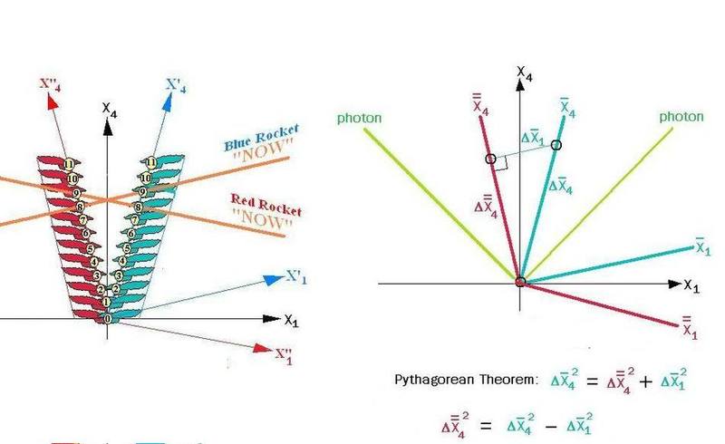

The block universe requires the 4th dimension actually be a spatial dimension. You could not have various 3-D cross-sections required by special relativity without that. The 4th dimension is identified with time because time seems to flow as the observer's consciousness appears to move along his world line (along his rest 4th dimension) at the speed of light.
Let's say everyone is required to move along the interstate from point A to point B at exactly 60 mph. Then, at every mile from point A there is a time marker on the side of the road, i.e., a clock, that reads out the time lapsed from point A. And instead of looking at an odometer, you look at your watch to keep track of time lapsed from point A (no distances are displayed). Now, you've turned the highway (your 3D world line, so to speak) into a time dimension in exactly the same sense that the 4th dimension is regarded as a time dimension.
So, the 4th dimension is a time dimension only in that sense. But, more fundamentally, the 4th dimension is a spatial dimension.
All of the 4-dimensional filaments strung along the 4th dimension that make up objects are just all there. On a macroscale the pattern posses unique forms that allow a description in terms of laws of physics. And from these laws you can predict the future 3-D cross-section organization of the objects. However, you cannot rely on these overall patterns to predict the future 3-D cross-section organization of objects down to the level of individual quark filaments, electron filaments, and photon filaments.
So, the 4-dimensional filaments are all there. You could say that the future is determined, but the rules we physicists have only work for predicting the future on a macro scale. We do not have rules capable of predicting the future of individual elementary particles. We can only predict statistically what to expect of a sizeable group of 4-D elementary particle filaments. And that's not because the filaments have not extended far enough along the 4th dimension; it's just because the filaments down at the sub-micro scale are not layed out with a fixed pattern reflecting the rules recognized at the macro level.
We have the wave functions, but a wave function is not, in this view, an actual object--it is a mathematical description which, when complex conjugate squared, allows you to make statistical predictions about the configuration of some 3-D cross-section of 4-D filaments at some point in the future.
One of the mysteries of the sub-micro patterns is that, even though we don't recognize a specific pattern conforming to specific laws of physicis, the wave functions have a very detailed and specific phase in it's description of the individual 4-D filament shape in 4-dimensional space.
Thus, we have two major mysteries of physics: 1) The many different cross-section views of 4-dimensional space (attended by the constant speed of light) and 2) The double-slit experiment of QM.

Hi, Peter. I think you've made very good points with that analysis. The other way to look at it may be seen with the sketches below. First, the left sketch symbolizes red and blue rockets moving away from each other with the same speeds relative to the black "rest" system. We have the usual time dilation. Red, when at his world line station 9, "sees" blue in red's simultaneous space at blue's world line station 8. But, blue, when at his station 9, "sees" red in blue's simultaneous space at red's world line station 8.
The 4-D metric, from which the Lorentz transformation time dilation equation follows is derived directly from 4 spatial dimensions. The selection of coordinates in the 4-space is simply selected based on orientations of 4-D world lines in the space. So, we have a right triangle with the blue X4 axis as the hypotenuse. The negative sign in the metric does not arise as a result of some mysterious role of time. It is just related to the orientation of world lines. It just results from the red X4 and blue X1 axes in the position of legs of the triangle. So, when we solve for the red X4 we're just solving for a leg of a right triangle instead of a hypotenuse. Some physicists refer to the red leg of the triangle as "Einstein's Hypotenuse."
No, it isn't, because the sign of the "time" term is opposite from the sign of the "space" term. In 4 spatial dimensions, the sign of all the terms would be the same and the metric would be positive definite. In 4-D spacetime, the metric is not positive definite. That makes a big difference.
Yes, the labeling of events by coordinates respects a standard R4 topology; coordinate 4-tuples that are almost the same represent points that are "close together" topologically, meaning they lie in small open neighborhoods of each other.
And look at how the axes are tilted relative to the black axes. If both dimensions were "spatial", so the metric was Euclidean, the red and blue sets of axes would each be perpendicular to each other, as the black axes are. But they're not. Minkowski spacetime is not Euclidean space. It's a different geometric object.
Also, I can play the same trick with Euclidean space, to make it look like the "metric" has a minus sign for one dimension. But that requires me to mix coordinates from two different frames on one side of the equation, which means it isn't a metric any more; it's just an equation that's been rearranged. A valid metric expression involves coordinates that are all from the same frame. For example, write the equation for the blue X4 in terms of the black X4 and X1; it will have a minus sign. *That* is the metric. I can rearrange that equation to move the negative term to the other side, but all that shows is that I can do algebra; it doesn't change the intrinsic geometry of the manifold.
That's not the way the block universe works. We begin with a Euclidean R4 manifold and freely select an initial set of coordinates using blue X1 and red X4 (blue and red X2 and X3 are the same). Do not regard the blue and red as belonging to two different coordinate systems at this stage.
Using these coordinates we have a distance along the blue X4 direction using Pythagorean theorem. Having these relationships we can now freely select a new set of coordinates, i.e., the blue coordinates X1, X2, X3 and X4. The Minkowski metric follows.
We have had no need to make any reference to time. It is all spatial. Now, if you wish to introduce a concept of time as an observer's consciousness moving along his X4 world line at the speed of light, you are free to postulate that and then investigate the implications and the consistency with special relativity theory.
Again, I don't like the concept at a subjective level. I'm just trying to do the best job I can at explaining the 4-D spatial universe concept. There are probably others on the forum who can make it more clear (and perhaps present it more accurately) than I. The link to Paul Davies's article given in the earlier post is good. I visited Davies's place at Arizona State University and hoped to meet him, but he was out of town on that day.
R4, yes. Euclidean, no, not if the metric ends up being Minkowski. "Euclidean" refers to a metric, not just a topology. Or at least, it does the way I am used to seeing the term used. If "Eucldiean" is just supposed to refer to the topology, then I have no problem with what's quoted above, but I would still object to the term "spatial" since it, too, implies a Euclidean, positive definite metric, at least as I am used to seeing the term used. The key is that there is a fundamental geometric difference between a Euclidean metric and a Minkowski metric, which is there no matter how you rearrange terms in equations. See below.
I don't need to introduce that to introduce a concept of "time". As soon as I have the Minkowski metric, I have one "direction" which is singled out from the others as being fundamentally different, because of the opposite sign in the metric.
I understand how the "block universe" concept *derives* temporal relationships instead of treating them as fundamental. Basically, some portions of the universe contain "records" of other portions, and you can use the "records" to create a temporal ordering on the entire block universe. That still doesn't change the fact that once you've created the temporal ordering, it is not a Euclidean ordering; the metric on the "block universe" is Minkowski and is not positive definite, so there is a fundamental physical difference between "temporal" relationships (a portion of the universe containing a "record" of another portion must be in the future light cone of the portion it contains a record of) and "spatial" relationships (between portions of the block universe that are spacelike separated, so neither portion can contain a "record" of the other).
But, I'm just establishing the Euclidean R4 with the blue X1 and red X4, then using the one-to-one correspondence between the Affine space (a generalization of Euclidean) and the orthonormal Euclidean space, S. So, we have the fundamental space, S, associated with the positive definite metric, then any point in the Affine space, A, can be reached with 4-tuples of a S vector using the basis vectors defining A.
I can understand your preference for not referring to a metric for the A space. You may wish to restrict the language to Affine coordinates associated with the S space (the S space having the positive definite metric). The 4-dimensional description of special relativity remains intact in this context.
No, what you're doing is mixing together coordinates from different coordinate charts on the same manifold. Your blue and red X1, X4 values are coordinates from different charts, so mixing them together the way you mix them does not count as a Euclidean metric. I agree that you have an affine space R4, where each point of the space can be labeled by a 4-tuple of values (X1, X2, X3, X4), but all the values have to be of the same "color" to evaluate whether the metric is positive definite or not.
Another way to see this is to ask what would happen if we tried to express red X1 in terms of blue X1 and X4, instead of red X4. The Minkowski metric formula gives:
(red X1)^2 = (blue X1)^2 - (blue X4)^2
We can rearrange this into your "Pythagorean" form:
(blue X1)^2 = (red X1)^2 + (blue X4)^2
There's only one problem: in this case, (red X1) is the *hypotenuse* of the triangle, not a leg! So clearly the actual metric of this manifold is not Euclidean and is not positive definite.
I'm selecting blue X1 and red X4 as coordinates on the same chart. The blue and red coordinates were initially described to make it easy to visualize what is going on with observers. But the manifold is independent of the observers, and we can freely choose our orthonormal coordinates on the manifold to define our metric space.
However, I agree that this becomes a convoluted way of getting there, because we then have to haggle over nitty gritty details of how did I know how to choose those same-chart coordinates without resorting to other spaces, etc. Physically, you look at a universe with a bunch of world lines running off in different directions and lay a coordinate down on one of them, then use some procedure to put down the remaining orthogonal coordinates. But, mathematically we have to argue over what the world lines are doing there and what the metric of the space was that defined their configurations in space, etc.
For this purpose it might have been simpler to just start with the black rest frame positive definite metric and then define the affine space using the appropriate Lorentz related basis. But then, the fundamental spatial character of the affine space seems more difficult for some to grasp, due to the negative sign. The method I was trying to show makes it quite clear how a negative sign arises in the 4-dimensional space.
But, in any case the negative sign should be no more of a problem than the negative sign showing up when solving for the leg of a right triangle. The triangle leg, Y, represented in the equation below is no more less spatial because of the negative sign.
The way you have written your equations, it seems like X1, X4 (regardless of color) are numbers, i.e., lengths along the lines along which they're marked. That means they can't be coordinates on the same chart; blue X1, X4 are coordinates on the blue chart, and red X1, X4 are coordinates on the red chart. Are you saying that you do not intend your X1, X4 of various colors to be numbers, but that each of them are 4-tuples giving the coordinates of the points you have labeled (presumably in the black coordinate chart)?
If you are thinking of them as 4-tuples, then I see why you are saying they are "coordinates on the same chart"; but you should recognize that you are squaring these 4-tuples, so they function in your equations exactly the same as if they are numbers taken from the chart of the appropriate color, because the "square" of a 4-tuple can only be its squared length, which is equivalent to a single number giving the corresponding coordinate from the chart of the given color--i.e., the squared length of the 4-tuple "blue X1" is the *coordinate* "blue X1", i.e., the X1-component of the 4-tuple from the blue coordinate chart that describes the indicated point. So both ways of talking about your X1, X4 of various colors are equivalent in this sense.
Also, none of this is relevant to the objections I've been making, which center around the fact that the metric of spacetime is not positive definite. See further comments below.
You can freely choose the coordinates, yes. But once you choose the coordinates, you can't freely choose the metric. The metric is determined by the actual, physical intervals between points, so the metric coefficients in your chosen coordinate system are fully determined once you have chosen your coordinates.
This is where you keep missing my point. The metric of the black "rest frame" is *NOT* positive definite. Squared intervals on the underlying spacetime can be positive, negative, or zero, and the metric has to capture that. The underlying spacetime, as a *metric space*, is *not* Euclidean.
An affine space doesn't have a metric; it doesn't "know" anything about lengths. You can define basis vectors, but since there is no metric, there is no way to assign squared lengths to the basis vectors, so you can't even express the concept of a "spatial" vector as opposed to some other kind, because you can't express the concept of a "squared length", let alone its sign.
As an *affine space*, yes, you can call R4 "Euclidean", as long as you remember that that *only* refers to the *affine* properties of Euclidean space, *not* its metrical properties.
Good job, Peter. Yes, you caught me red handed trying to pass the Affine space off as a metric. I'm too use to looking at a distance and calling it a metric (or not considering the mixed use of the term, "distance"). The usual treatment to get the metric is to use Minkowski's ict for X4, then get the ++++ signature. Einstein referred to that as a Euclidean space. But, I've never liked the ict treatment. I guess it works for mathematicians (and obviously for many physicists).
Anyway, you are a great asset for this physics forum. Thanks.
Yes, this treatment appears in many textbooks and many physicists seem to like it. Hawking, for example, uses it in his "no-boundary" proposal for quantum cosmology. (I'll see if I can dig up a reference.) And it's used a lot in quantum field theory in general, where it goes by the name "Wick rotation" to confuse lay people. But not all; IIRC, Misner, Thorne & Wheeler spend a page or so explaining why they *don't* use it. I'm not a great fan of it either, since it seems to me to obscure the physical distinction between time and space.
