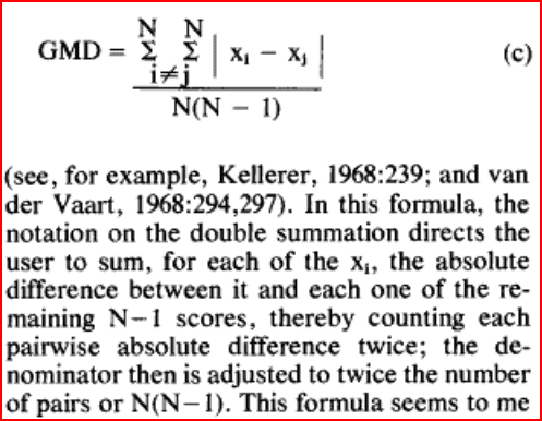

Thanks chiro for the insight. I feel a lot more confident using the formula now. The formula for the mean difference (which is what I assume when you said "mean distribution") is:

The formula you have is different than the one in the Wikipedia in a trivial way. The formula you give excludes the case i = j. Since |x_i - x_i| = 0 it seems unnecessary to do that.
The "GMD" is
\frac{ |1-2| + |1-4] + |2-4| + |2-1| + |2-4| + |4-1| + |4-2|}{(3)(3-1) } = \frac{12}{6} = 2
How do you define the variance of "the differences"? Are you going let each difference appear twice or just once? I don't think it matters for the usual definition of "sample variance".
If you count each difference once, you compute the variance of the data set {1,3,2}.
You get a mean of 2 and a variance of ( 1 + 1 +0) divided by 3, which is 2/3.
If you count each difference twice, you compute the variance of the data set {1,3,2,1,2,3}.
You get a mean of 2 and a variance of (1 + 1 + 0 + 1 + 0 + 1) divided by 6, which is also 2/3.
However, some people define the sample variance to be \frac{ \sum_{i=1}^n(x_i - \bar{x})^2 }{n-1} instead of \frac{ \sum_{i=1}^n(x_i - \bar{x})^2 }{n}. Those people would get 2/2 for the first answer and 4/5 for the second answer.
So our candidates for the sample standard deviation are \sqrt{\frac{2}{3}} ,\sqrt{\frac{2}{2}}, \sqrt{\frac{4}{5}}.
The method your propose:
1. Take the difference of the mean difference and each single difference
2. Square each result and add up the resulting numbers
3. Divide by the total number of differences
4. Take the square root of #3
Agrees with the answer \sqrt{\frac{2}{3}} doesn't it?
