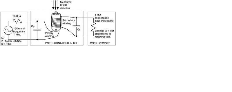

I'm driving an RLC network (in effect) with a square wave to saturate a ferrite core. The image is pretty close to what I'm trying to achieve. I need the circuit to be in the frequency range of 10-40kHz to resonate the secondary winding with the capacitor, but I also need to be able to output enough current to saturate the core (apprx. 200mA?).
Right now I'm using an LM392 opamp as a astable multivibrator to generate a square wave, but I haven't been able to get it to go over 2kHz...and the chip is limited to about 20mA on the output. I looked into 555 H-bridge circuits, but I need the circuit to produce a ±V square wave to saturate the core in both directions, and it didn't seem like the 555's would handle negative voltage. I looked at using a mixer and crystal oscillator to boost the frequency, but that still doesn't solve my current issue.
Does anyone know of a good way to achieve this? I just didn't know the words to search for in looking for other options, so I thought this would be a good place to ask for help.

The two windings are at right angles to each other. So in an ideal world, there would never be any signal on the oscilloscope.
Also I have some question how you believe this circuit should work.
Well, the primary winding doesn't induce a voltage onto the secondary directly. What happens is if you line the primary winding up with the field lines of a magnetic field that you want to measure, and then drive the primary winding with a sinusoid that will saturate it. Because the winding on one side is in the direction of the field that you're trying to measure and the other is 180 out, one core will stay in saturation longer and the other will come out of saturation earlier...and it's this difference in the cores that will produce a voltage in the secondary winding (at the second harmonic of the primary frequency).
You are correct though, in a perfect world with no external field there would be nothing produced on the secondary.
I'm just having trouble finding a circuit that can source the required amount of current, as well as be at the resonant frequency of the coil/cap on the secondary.
I might not have done a perfect job explaining how it works, but it's called a fluxgate magnetometer if you're curious about it.

I too have big doubts about the primary winding of your first picture. I expected it to make a field parallel to the sensed field in one core, antiparallel in the other, with the secondary summing both cores.
If the sensed field is huge, you could live with square waves filtered by an LC... But if you sense for instance Earth's field, you will need much cleaner sine waves. This can be made by active filters (but then, you need a very linear amplifier to deliver the 200mA) or by several stages of LC filters.
It seems you aren't needing a "negative voltage", you just need a square-wave whose current alternates in direction.
If you take a standard 555 astable and feed its output to another 555 having pins 2 & 6 joined together, the second chip acts as an inverter producing a square-wave in antiphase. Connect your transformer winding between their two pin 6 outputs to get the desired push-pull drive. Both 555s operates off the same single-ended power supply.
I think your application isn't critical in demanding that the drive level be exactly symmetrical, as here you are contending with variation between IC's for this. (I think asymmetry could be fixed by operating the inverting 555 from a separate power supply and tweaking its voltage very slightly, but probably totally unnecessary.)
