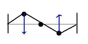

Consider a light elastic string of unstretched length ##4a_o##, stretched horizontally on a smooth surface between two fixed points a distance ##4a## apart. (##a > a_o)##. Three particles of mass m are attached so as to divide the string into four equal sections. Number the segments from left to right ##i = 1 - 4##. The tension ##T_i## in each segment ##i## is proportional to its extension ##(a-a_o)##, with the elastic constant being c>0.
Suppose that the particles are constrained such that they are able to move only perpendicular to the line along which the string is connected. The system as a whole is planar.
1) Write down the eqns of motion for the vertical displacement ##x_i## under the assumption that displacements are small. Keep only linear terms in ##x_i/a##. Show that in this approximation, the eqn takes the form ##\underline{\ddot{x}} + n^2 A \underline{x} = 0## and determine ##n## and the matrix ##A##.
(See diagram for picture)

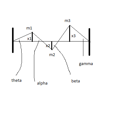

For mass m1, it is acted upon by T1 and T2. Defining two angles, ##\theta, \alpha## I get $$m_1 \ddot{x_1} = T_1 \sin \theta + T_2 \sin \alpha \Rightarrow m_1 \ddot{x_1} = T_1 \theta + T_2 \alpha$$ in the small angle approx.
To get expressions for the acceleration of the other masses, I defined another two angles ##\beta, \gamma## but the expressions were the same, when I sub in the below for the derived tension force.
Since the system is coupled, if mass m1 moves up then m2 also moves up. So change in length will be ##x_i - x_{i-1}##. This gives ##T_i X = c[a - a_0 + x_i - x_{i-1}]X, X## either ##\theta, \alpha, \beta, \gamma##. When I sub these in, rearrange I don't get the required form that I need to get to. I did a longitudinal version of this problem , and so I am trying to extrapolate what I did in that problem into this problem. Since we are dealing only with a perpendicular oscillations, the problem is rather similar. I think the ##x_i/a## terms come from expressing sin(X) = xi/a
I can post my working in pen showing detailed drawings etc if required /easier to understand my workings.

In the horizontal oscillations problem the correct tension force was ##T_i = c( a - a_o + x_i - x_{i -1})##. The set up of that problem was exactly the same, except there we had movement of masses longitudinal and not transverse. Is there something i can do with that to apply it to this problem? Do I need to express the tension force in terms of the displacements x1, x2 and x3?
You just need to find the forces of tension. You started (almost) correctly: the force acting on the first mass is ## T_1 \sin \theta + T_2 \sin \alpha ## Now, ## T_1 = c (\sqrt {a^2 + x_1^2} - a_0) ##, and ## \sin \theta = \frac {x_1} {\sqrt {a^2 + x_1^2}} ##, so the first term of force is ## c (x_1 - \frac {a_0 x_1} {\sqrt {a^2 + x_1^2}}) \approx c(x_1 - \frac {a_0}{a} x_1) = c(1 - \frac {a_0}{a}) x_1 ##. The second term looks trickier, but observe that the geometry involved is the same, provided we replace ## x_1 \rightarrow x_1 - x_2 ##, so we can fast forward to ## c(1 - \frac {a_0}{a}) (x_1 - x_2)##, and the force acting the first mass is ## c(1 - \frac {a_0}{a}) (2x_1 - x_2)##.
Now let's go back to the "almost" remark above. Think about the direction of the force and the sign you should assign to ## c(1 - \frac {a_0}{a}) (2x_1 - x_2)##.

If I take y as positive down, then ##T_1 \sin \theta## acts downwards and so would be postive.

Yes, this is the hypotenuse (h) and so is the length of the string between its left-most point and the first mass. Then the force is ## c(h - a_0) ##.
I am not sure I really understand this step.
The second triangle is very much alike the first triangle. Except its vertical cathetus is ## x_1 - x_2 ##.
What is "y"?
Note it is not important whether "up" is positive or negative. What is important is the direction of ##x_1## and the direction of the force acting on the first mass. Assuming ##x_2 = 0 ##, is it the same direction?

So if m2 stays in place (x2 = 0) and m1 is displaced by x1 vertically (is this what you meant?) then I think the force (T1 sin θ) would still point downwards. If x2 = 0 and x1 = 0 then T1 points leftwards and T2 rightwards.
Refer to your drawing. The first triangle is the left-most triangle there. The second triangle is the one that follows it, whose vertices are m1 and m2 and the unmarked point under m1 and to the left of m2 (so that the triangle is right).
The arrow means "replace with", just like the text says.
Alternatively, you could consider the case of a string which is stretched to a horizontally, and then its ends are moved vertically so that the vertical distance between them is d. Find out the vertical force of tension in terms of a and d. Then you could translate this to any segment in the original problem, by expressing d via x's.
If x2 = 0, the force is downward if x1 is upward. What does that mean with regard to its sign?

So for the first mass, I can write: $$m\ddot{x_1} = -T_1 \sin \theta + T_2 \sin \alpha = -(c(\sqrt{x_1^2 + a^2} - a_o) \cdot \frac{x_1}{\sqrt{x_1^2 + a^2}}) + c(\sqrt{x_2^2 + a^2} -a_o) \cdot \frac{x_2}{\sqrt{x_2^2 + a^2}}. $$Taking the small displacement approx gives in the end, $$c(-x_1 - \frac{a_0}{a}x_1 + x_2 - \frac{a_o}{a}x_2)$$
I don't think it is the same as what you got?
No it is not. Specifically, the second term is wrong. I advise that you do the "alternative" problem in my post #8. Then apply the solution to the second term.

So a string has some extension a in the horizontal direction. It then has some vertical extension d. So the distance between the ends is ##\sqrt{d^2 + a^2} ##. So ##T_1 = -c(\sqrt{x_1^2 + a^2} - a_o)## since ##x_1## is the vertical distance in this case.
For m2, the distance between the ends are x1 + x2. So then ##T_2 = c(\sqrt{(x_1 + x_2)^2 + a^2} -a_o)##
This is correct, but this is not the end. Work out the linear formula for the isolated case, then use it for all the segments.

So, $$T_2 \sin \alpha = c(\sqrt{(x_1 + x_2)^2 + a^2} -a_o) \cdot \frac{x_1 + x_2}{\sqrt{(x_1 + x_2)^2 + a^2}}$$
When added to the expression for T1sinθ, I get $$-cx_1 -ca_ox_1/a + c(x_1 + x_2) - \frac{ca_o(x_1 + x_2)}{\sqrt{(x_1+x_2)^2 +a^2}} = + cx_2 - 2ca_ox_1/a - cx_2 a_o/a = -c(2a_ox_1/a - x_2 + x_2 a_o/a)$$ which is close.
I just noted that you let d = x1 + x2 in #13. This cannot be correct. If x1 = x2, then you get a positive vertical distance, while it should be zero.
Secondly, you did not get the linear formula of force in terms of d. You got Ti (assuming you correct the x1 + x2 issue), but what you need is its vertical component.

If m1 goes up by an amount x1 and m2 down by an amount x2, then the distance between them is x1 + x2. Since the string is also stretched in horizontal direction, I sum the squares of these and sqrt (to get the distance between the two ends of that piece of string)?
So, like $$|T_i| = c(\sqrt{(x_i + (?) x_j)^2 + a^2} -a_o) \cdot \frac{(x_i + (?) x_j)}{\sqrt{(x_i + x_j)^2 + a^2}}$$ (I added a question mark because still unsure about this)

You can't use different sign conventions for x1 and x2. If m1 goes up, x1 is positive; if m2 goes down, x2 is negative.
I suggest you forget about x_i and x_j for a second and solve the simpler problem with vertical separation d - down to expressing the force linearly in d. Then you can substitute x_i and x_j.

Then I have d = x1 - x2 for m2
$$|T_i| = c(\sqrt{d^2 + a^2} - a_o) \cdot \left(\frac{d}{\sqrt{d^2 + a^2}}\right)$$
EDIT: Forgot to express down to linear in d...
$$= c(d) - ca_o(d)/a$$

So you got ## c(1 - \frac {a_0} {a}) d ##, which is correct. Now you just need to find d for each segment and write down the forces in each segment. Minding their signs.
For mass m1: $$m\ddot{x_1} = -c(1 - \frac{a}{a_o})[2x_1 - x_2]$$
For mass m2: $$m\ddot{x_2} = c(1 - \frac{a}{a_o})[x_1 + x_3 - 2x_2]$$
For mass m3: $$m\ddot{x_3} = -c(1 - \frac{a}{a_o})[2x_3 - x_2]$$

A normal mode is a special motion of the masses in the system: All of them vibrate with the same frequency and in/=out phase. The relative amplitudes constitute the eigen vectors. In this case, you have three 3 dimensional eigenvectors, a, b, c. It is usual to choose them of unit length.
So the eigen vector belonging to the ω1=√(2T/m ) angular frequency is a=(1/√2, 0, -1/√2). You can see this eigenvector in the attachment. Check the others and make them normalised. I do not see where the √5 came from, and I think you have a sign error in the third eigenvector.
The general motion of the three masses is a linear combination of the normal modes. This motion is also represented by a three-dimensional vector, its components belong to the masses 1,2,3.
(x1,x2,x3)=A(a1,a2,a3)sin(ω1t+θ1)+B(b1,b2,b3)sin(ω2t+θ2)+C(c1,c2,c3)sin(ω3t+θ3).
ehild
  • #49
Was there an attachment did you say? The minus was a typo and the sqrt{5} was an error in computing the scaling factor to make the vector normalised. It should be 1/2<1, -##\sqrt{2}##,1> for the second eigenvector and 1/2<1,##\sqrt{2}##,1> for the third eigenvector.
[/QUOTE]
  • #50
I attached the picture.
ehild
