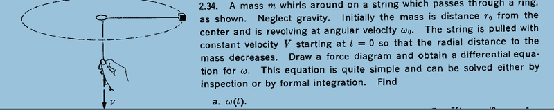

In the solution , it says we have dr/dt= -V (polar coordinates)
How? i can't see how this can be possible , we know that r(t)=V/w(t), and that's it .
Andrax said:
In the solution , it says we have dr/dt= -V (polar coordinates) How? i can't see how this can be possible ,
r gets smaller as the vertical string gets longer.
Why?
You have to be careful when using equations in physics. You cannot just blindly plug in variables, you need to know what each variable means.
In this problem V is NOT the tangential velocity so V is not equal to rw as it is in many circular motion problems. Here V is the velocity of the downward pull on the string.
thank you , the differential equations gives me w(t)=2 if i use V=rw , i just presumed that since it's alays used in these kind of problems
