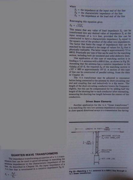

If that is the logic, all I need is to put a small section of tx line and use a relay to snap in a very low impedance voltage source ( say a good low loss cap charged up to say 10V). This create a step function that contain broad frequency components, then one of the frequency will have the quarter wave equal to the length of the tx line and you should get very high voltage out of it. This will eliminate the ignition coil in cars, you get sparks out of a transmission line with a low impedance step generator.
My understanding is you can inject in power, but if you an not having a perfect match on the line ( which depend on the termination of the line where in this case is open), reflected power just shoot back into the generator and the result is you cannot put in the power that you want. I think you are assuming that you inject the power and the tx line is going to take in all the power. But in real life, the power just got reflected back if the the transmission line system is not a perfect match and you only get double the voltage at the open end. This is how I understand it. I would like to see some material otherwise.
yungman, when you were designing transmission line filters and matching networks, what frequencies did you work with? When you were designing matching networks, I presume you obtained good matches in which nearly all the power was transferred to the load with a low VSWR or return loss. If the load impedance was higher than the source impedance, how could the power supplied by the source be dissipated in the load unless the voltage was higher at the load? Neither vk6kro nor I am talking about reflection from the load. In our posts we are talking about perfectly matched sources and loads. A transmission line can act as a transformer to transform impedances and voltages just as do matching networks or transformers.
Above is an excerpt from the ARRL Antenna Handbook 1988 edition .
Or, you could check Terman's book "Electronic and Radio Engineering" 1955 ed, P120. This is regarded as a Bible by most of us.
This is an unusually useful technique and it would be covered in almost any book on transmission lines or antennas. Your local library or technical bookshop would easily provide such a book.
Yeh, you two are right, I was watching tv and it just dawn on me! I remember now that I actually design using quarter wave line to transform from low impedance to high impedance and have perfect matching for max power transfer. The voltage got to be more than double. I was so sure I was right that I was so dead wrong.
Sorry, it's been over 6 year since I was working and I have not been using it, things start leaking out the wrong end:cry:, blame it on old age!
