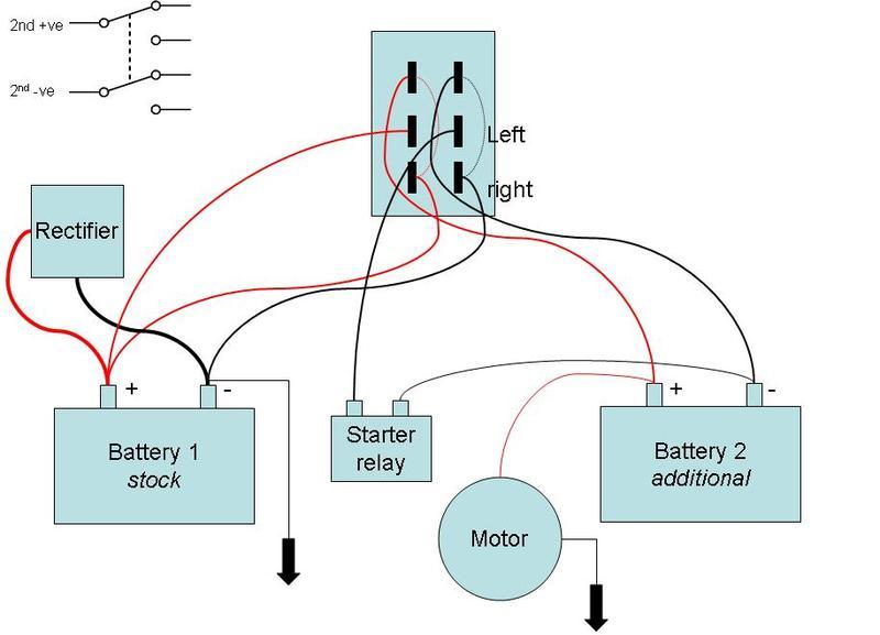

hi all,
i have this qns which i been figuring, but can't get the right circuit.
i have 2 12v batteries. which i want to wire in series to give it a 24v starting to a motor.
however by doing that, i am unable to charge both batteries as my rectifier is only able to charge 12v. I need to make it to become "one" battery by making it parallel.
i think about it and i guess it need a DPDT switch to do the job.
but not sure about the circuit layout.
can any kind soul advise me. thanks
Thanks

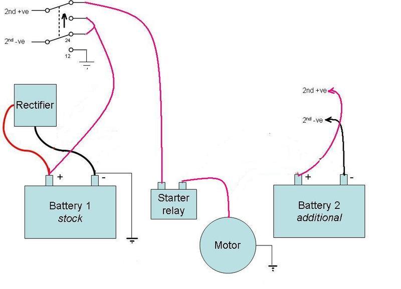

hmm i have draw out a circuit maybe some can advise if this is correct as what was mentioned
i have attached the original circuit, and the added on.

I have attached a circuit which may be what you were describing.
This shows the batteries being in parallel most of the time and hopefully charging from the vehicle battery charging system. This normally involves putting rectifiers in series with each battery, but I haven't shown that.
When the starter switch is activated the relay contacts move across and connect the two batteries in series.
This is not a practical circuit, though, as the currents involved would be huge.
