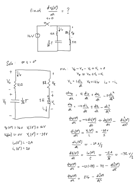

FIND dvR(0+)/dt for the circuit depicted below.
See the attached photo.
I was stuck with the last line of my solution please help me find the correct answer to this problem. TIA!
Hint: You have the value of diL (0+)/dt.
Yes I know that diL (0+)/dt = -24 A/s but isn't diL^2 (0+)/dt^2 = 0?
Can you write VR in terms of IL?
