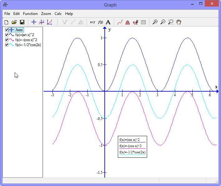

Strange, since these functions without the cubes look different

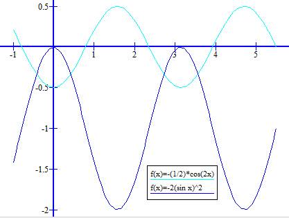

But:
$$-\frac{1}{2}\cos(2x)\neq -2\sin^2 x+C$$
Karol said:
But:
See post #6 for the correct relationship.
$$-\frac{1}{2}\cos(2x)=-\frac{1}{2}+\sin^2 x=\sin^2 x+C$$
