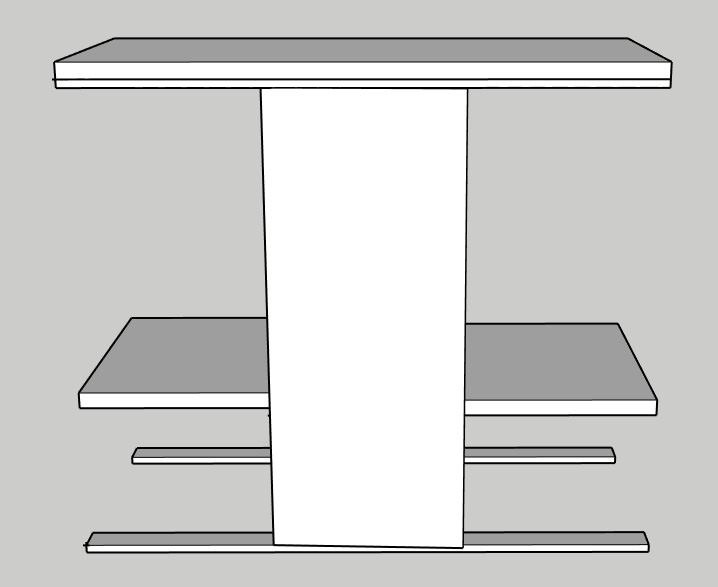

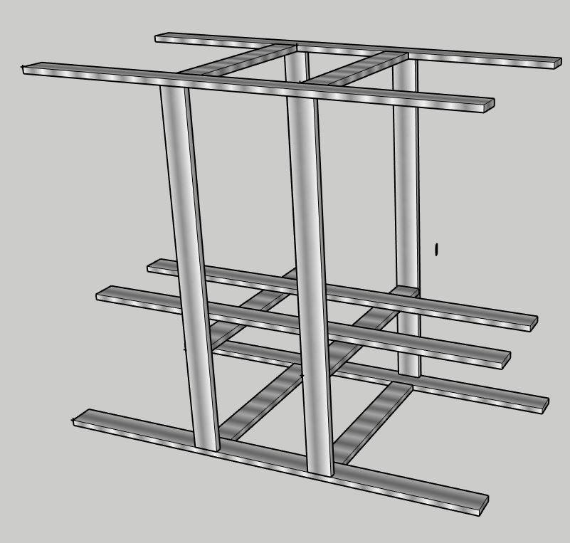

Sup gyz, I have designed an aquarium stand to house 3 aquariums. I am not a technical person, please let me know if this is a sustainable stand.
Please help me to find out if this is a feasible project. If not, what changes shall be made to make it sustainable for a long time without changing the layout?
1. Details of the stand: L 36", W 18", H 30"
2. Details of Aquarium 1: L 36", W 18", H 18", weight: 225kg
3. Details of Aquarium 2 and 3: H 12", W 12", L 12", weight 40kg each
4. Total aquarium load for this project will be 300kg
5. The frame will be made of 1mm 2" X 1/2" MS Tube (Metal Tube)
6. 1" Board will be used on the Metal Frame to ensure even support for aquarium bottom
  • Wireframe 3D sketch of a stand with two vertical posts and horizontal crossbars at top, middle and bottom, with shelf-like plates at the middle and lower levels.

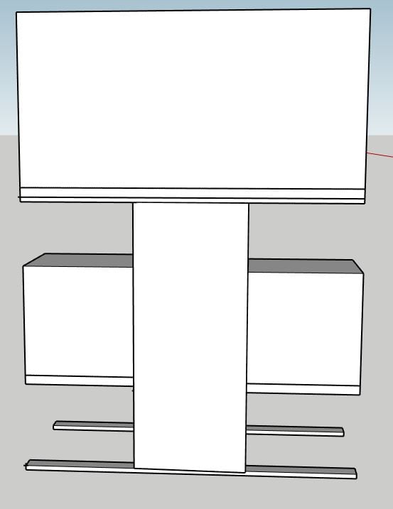

  • Side-view line drawing of a stand with a wide top shelf, a wide middle shelf, two narrow lower shelves, and a single central vertical pillar supporting them.
  • SketchUp-style 3D model of an aquarium stand: a large tank on top, a central vertical support, two lower shelves, and two thin horizontal rails at the bottom.

Rectangular tube will flex less if it is used on edge rather than on the flat as you show it.
The two lower tanks are supported on a cantilever that projects from the midpoint of a cross tube. That is not a reliable support, it will flex with every movement until the joins fracture.
The two cantilevers could be made from one continuous metal tube. Or better, there should be two continuous full length tubes, one at the front and one at the back.

Thank you mate for your opinion. I will consider your feedback and redesign the model for bottom aquariums. However, do you think that the top aquarium of 220 kg can stay peacefully in the present design?

This is bordering on a dangerous project, so keep in mind that the thread may be closed at some point.
As @Baluncore points out, a cantilever design is not a good match for such a heavy load. Each load should be supported at least at all four corners directly to the floor/ground.
The layout of the stand looks a bit odd to me as well. Are you really intending for people to get down on the floor to look into the bottom two tanks? Or is this stand meant to sit up on a table of some sort?
Where will these aquariums be located? What happens if the stand fails and they end up crashing down -- would water damage be a problem where this will be, or will the water drain out of the area easily? Will the aquariums be made of glass or plastic?

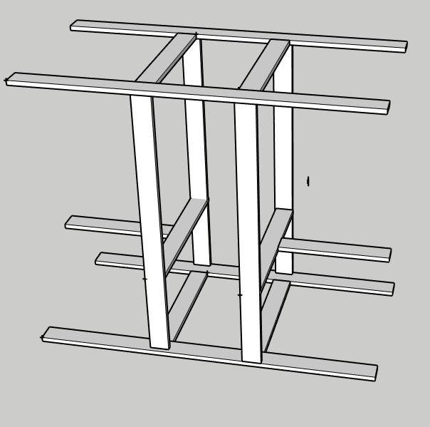

I redesigned the model as per your observation. Please share your opinion on this.
  • 3D model render of a wood-frame stand with four vertical posts, horizontal rails at several heights, and diagonal cross braces connecting the lower and upper frames.
It is better, but it is too springy.
The tube is still being used flat and is not on edge.
Closing the tubular framework loop will give it more strength and rigidity.
