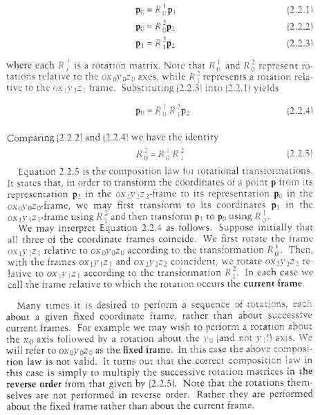

I found a source that I believe addresses the questions I have, though I am still trying to grasp what is going on. See attached. "Composition of Rotations" starts on pg 38. I will reiterate just so I can understand it.
Rotation matrix ##R^1_0## represents a rotational transformation between frames ##\vec{ox}_0## and ##\vec{ox}_1##. So given a vector w.r.t. ##\vec{ox}_1##, ##\vec{p}_1##, you can transform that vector into the ##\vec{ox}_0## frame by ##R^1_0\vec{p}_1##.
Now suppose you have a third frame, ##\vec{ox}_3##. We have the following:
##R^1_0## : rotation between frame 0 and 1
##R^2_0## : rotation between frame 0 and 2
##R^2_1## : rotation between frame 1 and 2
##\vec{p}_0##, ##\vec{p}_1##, ##\vec{p}_2## are vectors wrt frame 0, frame 1, and frame 2, respectively.
##\vec{p}_0 = R^1_0\vec{p}_1## : take vector wrt frame 1 and transforms it to frame 0 coordinates
##\vec{p}_0 = R^2_0\vec{p}_2## : take vector wrt frame 2 and transforms it to frame 0 coordinates
##\vec{p}_1 = R^2_1\vec{p}_2## : take vector wrt frame 2 and transforms it to frame 1 coordinates
Combining:
##\vec{p}_0 = R^1_{0}R^2_1\vec{p}_2 = R^2_0\vec{p}_2##
This makes sense to me and by using this I was able to the correct rotation matrix from the example I gave before (by using intermediate frames). This I pulled from the attached source makes has a good explanation, esp the last paragraph:
So I think I understand that. But, now going back to the Euler angles I posted before. I tried this method and got the reverse sequence of transformations. I think it has to do with what direction you are transforming, i.e. are you transforming from your final frame to your fixed frame, or from your fixed frame to your final frame?
So, at least for now, I've drawn this conclusion: If you are making sequential transformations by transforming about intermediate frames, the transformation matrices are multiplied in order, from left to right (i.e. T1*T2*T3*...*Tn). If you are making sequential transformation but around a fixed axis, the transformation matrices are multiplied right to left (i.e. Tn*...*T3*T2*T1).

I believe I figured out all of my problems. It came down to intrinsic (using intermediate frames) vs. extrinsic (using the fixed frame) transformations as well as forward and inverse transformations.
Believe it or not wikipedia had the best information on all of this. I skimmed across it before, but that must have been before I knew what I was looking for. It explains intrinsic and extrinsic rotations pretty thoroughly.
Then, the reason I was getting stuck with that MIT paper I referenced is that they are doing the inverse transformation (i.e. given a vector in the fixed frame X-Y-Z coordinates, transform it into the rotating frame x-y-z coordinates), instead of the normal forward transformation from rotating frame coordinates into fixed frame coordinates. Wikipedia lists the forward, intrinsic Euler angles. Lo and behold, if you take the forward, intrinsic ZXZ Euler angles from wikipedia and transpose it to get the inverse, you get the answer from the MIT paper.
